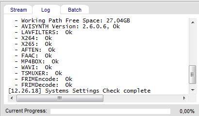

    Hi Kerry and thank you for your reply.
    I did Inspect function and i got this (all ok)
    [Attachment 47625 - Click to enlarge]

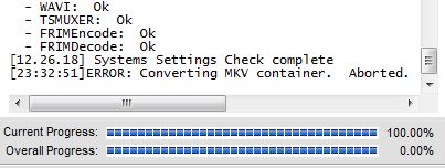

    And after that (it did current progress to 100%) i got error message and abort, like this
    [Attachment 47626 - Click to enlarge]
    Any idea why is that happening?
    Thank you once again
  4. Banned
    Feb 2013
    You don't have enough free space, most likely (27.04GB)
    How big is the file you are importing?
    Dec 2018
    Ireland
    Maybe that's the issue, yes. File is 31 GB. I was thinking that i will need around 24 GB of empty space. I have 26,9GB on the disc where I'm saving. Looks like i have to clear that out a bit.

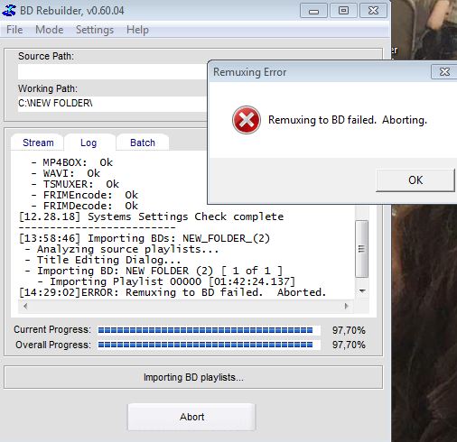

    So unfortunately, BD Rebuilder didn't work for me. I had all the necessary programes installed such as AviSynth, FFDShow, etc, but it keeps coming back with the same error (picture below)
    [Attachment 47632 - Click to enlarge]
    I cleared my HDD, plenty of free space to work with but always error and abort. Since that is not working i would like to ask this;
    1. Any other program that you can recommend that will do the same for me?
    2. In case i have already converted mkv to blu ray and i have BDMV and CERTIFICATE folders but i still have more than 30 GB in size, can i shrink that file to 25 GB so it can fit on disc? DVD Fab maybe?
    Thank you once again for all your help

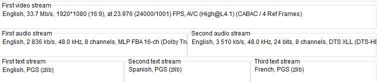

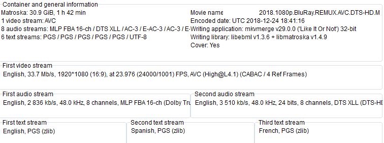

    Can you post a mediainfo report on the mkv?
    Of course, here it is
    [Attachment 47663 - Click to enlarge]
    Thank you

    Can you repeat with text view, shows more info?

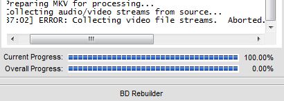

    Woohoo, success!
    I did exactly what you said, but i did it with trimmed mkv file so i don't have to waste all day converting. Process;
    1. Imported MKV into MKVToolNix, with subtitles (and i marked them as burn in just to stay on the safe side)
    2. Newly created file i imported into BD Rebuilder and it worked perfectly fine. It converted file in few minutes and it's great. It looks like there was an issue with the available space in disc.
    Here is the complete log;

    I'm running low and i left around 35 GB of free space
    definitely an issue
    have about 2.5x free space of the file size
    i.e.
    10GB file >> 25GB free space
