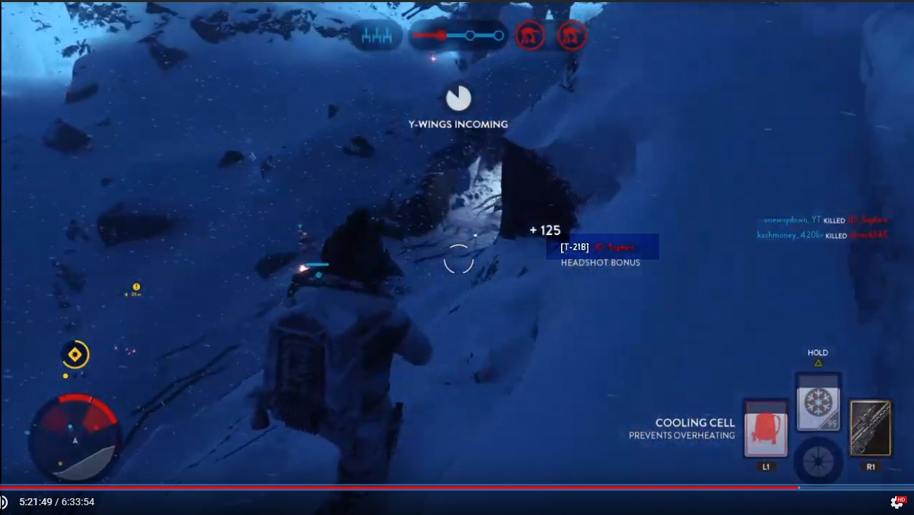

    Well, right now they're all saved PS4 streams on Youtube. Sample vid is here - https://www.youtube.com/watch?v=ChIA5gmAkRI
    Quality isn't the best, due to the lack of bitrate options on the PS4. However, attached is a sample, where the personal kill feed is in the middle, slight right, and left justified, where it indicates the [weapon] in white and then the gamer name of the person killed in red text. The exact starting placement of the red text will vary due to difference in weapon name lengths but it's still the same basic area.
    [Attachment 47642 - Click to enlarge]
    It would be cool to be able to automatically detect any red pixels in that area and create a list of timestamps for me to go review later. I mean, it would be real awesome if it could cut/trim that section of the vid to a new file but all I really need are the timestamps. I have dozens of 5-6hr streams that I don't want to rewatch completely just to find some of my kills.

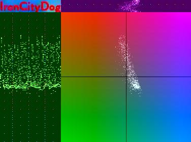

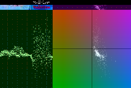

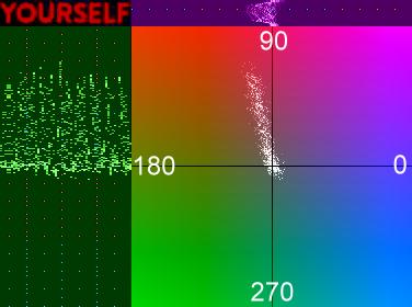

  5. I downloaded part of the 720p video and came up with this:
    LWLibavVideoSource("Star Wars Battlefront PS4.mkv")
    Crop(580,240,120,24)
    SelectEvery(180) # every 180'th frame, 3 seconds at 60 fps
    MaskHS(startHue=90.0, endHue=105.0, MinSat=30)
    WriteFileIf(last, "log.txt", "AverageLuma>20", "current_frame*180" ) # multiply by 180 to get original frame number
    That opens the video, crops it to just the area where the kill messages appear, looks at that area (only every 3 seconds) for saturated reds, and writes the frame number to log.txt if reds are found. That means it will generate false positives if other red objects appear in that area. It may miss some kills if the message lasts for less than 3 seconds.
    You'll have to change the file name and the crop area if the frame size is different. Open the script in an editor and run through it from beginning to end to force the entire file to be searched (I like to use VirtualDub, File -> Run Video Analysis Pass). Note that log.txt is appended to each time you run the script -- so delete it before you run the script. It took about 30 seconds to search through a 12 minute clip.
    I had to use a fairly wide hue range for detecting the red text. That was because the message is is semi transparent so the color shifts a bit depending on the background. You may also need to adjust the average luma threshold. Higher if you get too many false positives, lower if you miss some kill messages.

    Here's a UV plot of the chroma channels when the red text falls on a black background:
    [Attachment 47707 - Click to enlarge]
    The colorful graph at the lower left is the UV plot (the whole image has its saturation increased to make the colors more intense for demonstration purposes). The white spots indicate colors that appear in the frame. I've labeled the hue angles (0, 90, 180, 270). The center of the graph represents low saturation, the outer edges high saturation. The black background has low saturation so it produces most of the white dots near the center. The dots closer to the top of the graph along the ~110 degree line are the red text. The text is antialiased and blended with the black background producing all the dots in between along that line.
    When the red text appears over a cyan background (pretty much the opposite of red) the reds are changed:
    [Attachment 47708 - Click to enlarge]
    the dots in the graph are shifted to the right and down. So I couldn't look just for dots at 110 degrees with high saturation. I had to widen the range to accommodate different backgrounds.

    [Attachment 47763 - Click to enlarge]
    At the top left you can see map of reds found by MaskHS. Right below that you can see the original crop from which the map was built. At the bottom right is the UV plot. Log.txt:
