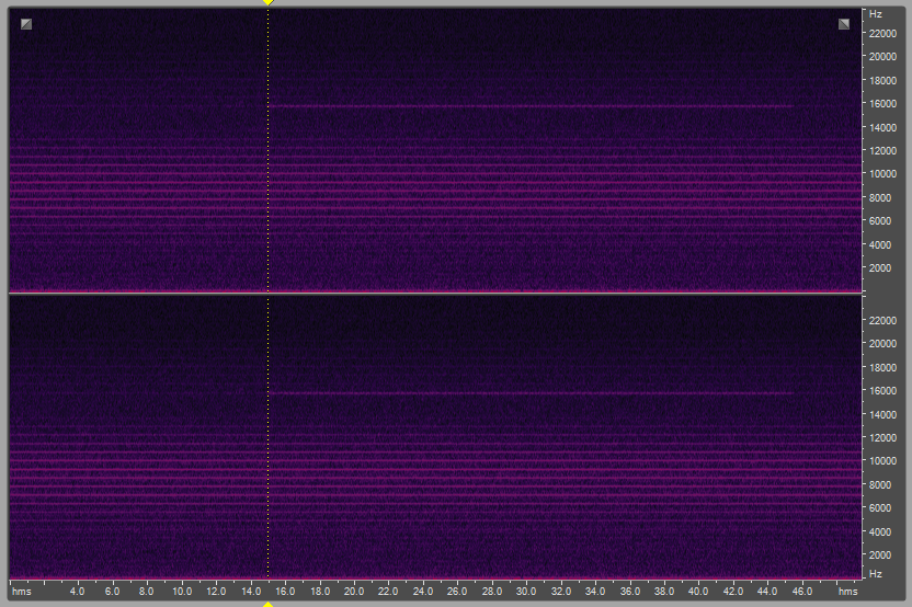

    [Attachment 47615 - Click to enlarge]

    I believe the buzzing is coming from the 5-12khz range. I'm not sure what happens at the 15-sec mark, but the picture is unaffected at that mark.

    The VHS is about 70 mins long. I attached a screenshot from Spek that shows the buzzing at various frequencies for the entire recording. The buzzing continues even after the VHS is done playing, which makes me think the problem is with the JVC and not the VHS. Maybe this will help diagnose the problem.

  6. First, anything over a few thousand kHz is usually not classified as a "buzz." It's a nit, but until I saw your spectrum chart of the WAV, I thought you had different problems.
    The frequency shown by that horizontal line is almost certainly the 15.734 kHz horizontal scan frequency. I understand the signal theory behind NTSC TV, but not the details of the electronics, so someone else will have to tell you what is the likely cause of frequency getting through. However, in my own experience, virtually every VHS capture I've made, using over a dozen different VHS decks, all have this frequency present. It is usually inaudible to all but the best, youngest ears. I used to be able to hear it easily, but in my dotage, that is gone.
    I doubt you'll be able to modify your equipment to eliminate it, so the easiest thing to do is get a good sound restoration tool and simply notch it out. You should be able to do that without introducing any new artifacts. I use iZotope RX, but that is expensive. I think Audacity (free) may have a good notch filter, but someone else will have to confirm that.
    That will be quite laborious as there are many harmonic components of this hum. It's not just around 15 kHz.

    That will depend on the tool used. With iZotope RX, I can specify up to eight harmonics. Once the preset is created, it will remove all of them in one pass.
    This stock image shows all harmonics getting the same treatment, but you can change many of the parameters for each one.
    Of course once you get into removing harmonics of a 15 kHz tone which is so high that most people can't hear it, you get pretty close to the point where only your dog will notice. I'm still wondering what the OP was actually hearing because this frequency is so high that no one would mistake it for a buzz. Perhaps there was some other noise that is not showing up on the spectrum display posted.

    In the spectral display I posted, there are more than a dozen noise components below 15 kHz.
  10. That noise is at -45 dB -- that's about the noise floor of VHS's linear track anyway. There's a reason it's not called HiFi.
    And yes, there are many peaks in the spectrogram below the 15 KHz one. Many at 30 Hz and harmonics, and 24 Hz and harmonics. The most annoying ones are between ~6K and ~12K, many harmonics of 59.94 Hz.
