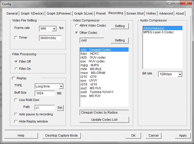

    I have to figure out how to install more codecs there like Lagarith and HuffYUV, I don't see them on the list:

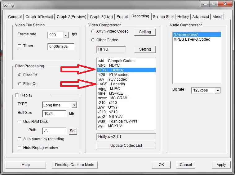

    I didn't have to install AmaRecTV, I just run the application from the downloaded folder, So I don't think I'd need any registry cleaning, As for pluggins, Lagarith was installed correctly and appeared on the list, But HuffUYV is just a dll file I will have to figure out where to put it so it can appear on the AmaRecTV pluggin list.

    There is a command line instruction that didn't work for me, I tried moving the file to C and tried putting the exact file path nothing worked, I had it working before on VertDub by dropping it on specific folder but AmaRecTV doesn't have such folder.
  12. Capturing Memories dellsam34's Avatar
    Jan 2016
    Never mind I figure it out. I wasn't using CMD as administrator, I had to type in CMD in the search bar and when it appeared I right click on it and clicked "Run as administrator" worked with no errors, Had to put the file on the root C:
    Microsoft Windows [Version 6.1.7601]
    Copyright (c) 2009 Microsoft Corporation. All rights reserved.
    C:\Windows\system32>cd c:\windows\syswow64
    c:\Windows\SysWOW64>rundll32.exe setupapi.dll,InstallHinfSection DefaultInstall 0 c:\huffyuv.inf
    Now AmaRecTV displays both codecs:
