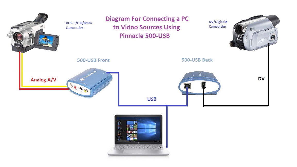

    1-When you connect the device with a firewire cable to the camcorder and playback a DV tape, it will transfer the DV stream to the computer via USB cable and control the camcorder functions from within a DV application such as WinDV. You can also capture analog Hi8/8mm tapes using Digital8 camcorder with this setup in DV format.
    2- When connected using S-Video/Composite/Stereo it will capture analog video/audio and transfer it to the computer via the USB cable in a lossy or losseless formats using applications such as VertualDub.
    Look for any Pinnacle capture device that has both the DV and USB ports, Models like 500-USB, 510-USB, 700-USB, 710-USB.

    Here is a diagram of different possibilities of the Pinnacle devices based on the video source:
