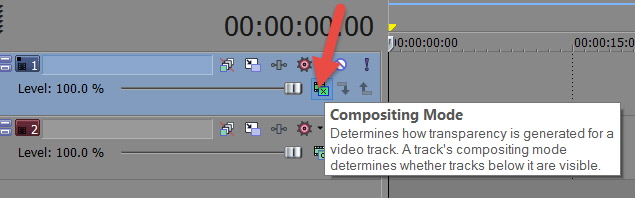

left click the button indicated by the arrow
[Attachment 47567 - Click to enlarge]

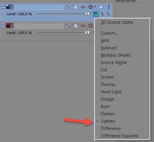

select lighten
[Attachment 47568 - Click to enlarge]
It might be slightly different in newer vegas versions
