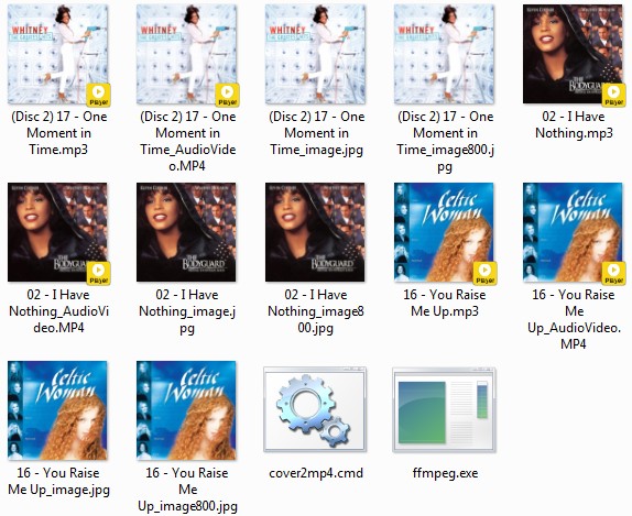

	Just tested this script saved as a .CMD file in a folder with MP3's with cover art as well as the FFMpeg file. It produces an image with the MP3 file name in it and also creates a
 larger 800x800 image in case you wanted it larger with same resolution. These lines can be stripped/changed as required but it does produce the MP4 with audio and cover art.
 Code:setlocal enabledelayedexpansion ::echo off for %%a in (*.mp3) Do ( set /a count=0 cd %%~dpa set /a Number=0 ffmpeg.exe -i "%%a" -an -vcodec copy "%%~na_image.jpg" ffmpeg.exe -i "%%~na_image.jpg" -f image2 -vf scale=800:-1 "%%~na_image800.jpg" ffmpeg -loop 1 -f image2 -i "%%~na_image800.jpg"^ -i "%%a" -map 0:0 -map 1:0 -acodec copy -vcodec libx264 -r 30 -shortest -pix_fmt yuv420p^ "%%~na_AudioVideo.MP4" set /a count+=1 ) echo !count! files converted pause
 [Attachment 47573 - Click to enlarge]
	Now thats excellent work too.. just 2 glitches. fps is 30 which is more than enough for a video with just one still pic.. and secondly the last command COUNT .. it counted 1 though it converted 2 mp3 files I kept in that folder. I see so many people who upload audios on youtube. In the absence of any such software.. so if this script can get some GUI with proper input options like which screen size, which bit-rate (video and audio) and fps so that person using it can get various results then may be it can bring some bucks for the programmer too

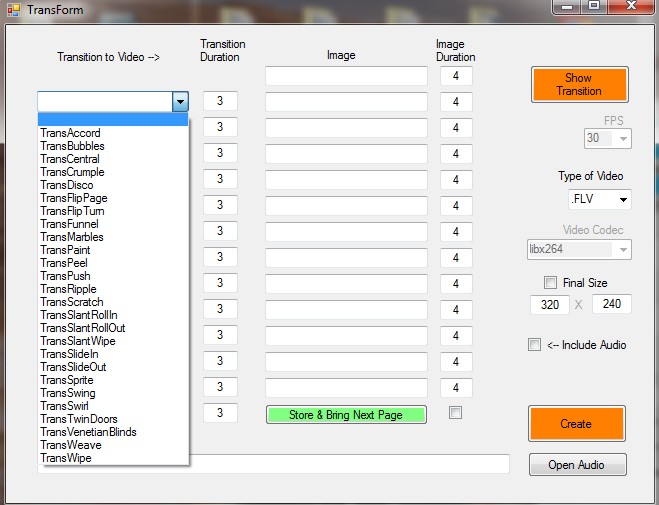

	Is there a need for an image2video or possibly image(S)2video with maybe transitions between them?
 [Attachment 47607 - Click to enlarge]
 [Attachment 47608 - Click to enlarge]
	Yess.. this looks cool.. Hope there is also a switch of Transition On/Off ..and also Random Transitions check box on top of effects list.
 Also Video Screen Size and FPS are a must requirement to include..
 Among Audios .. the options should not be limited to mp3 only because professionally WAV and FLAC are used preferably.Last edited by Love; 24th Dec 2018 at 04:35.
