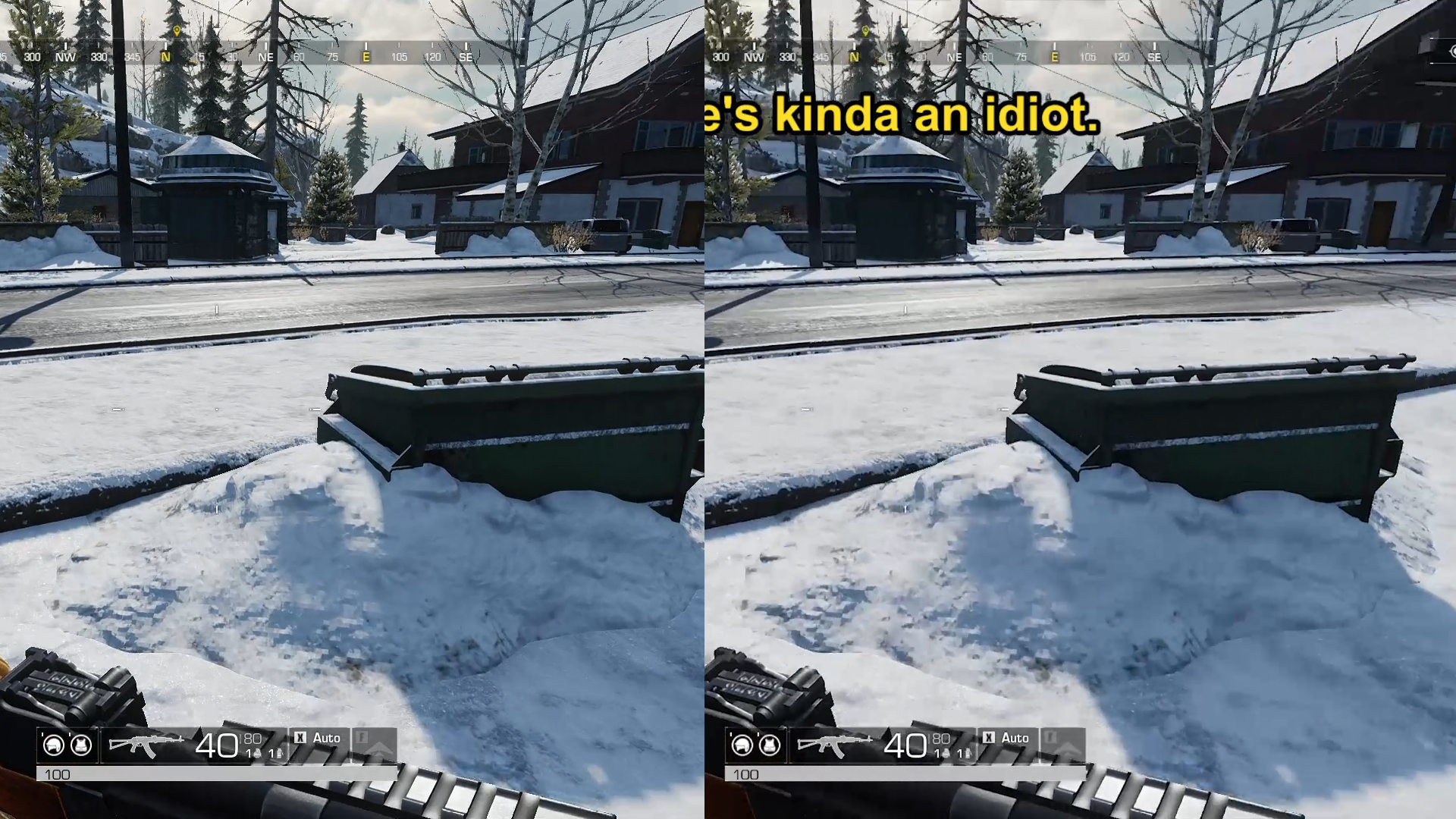

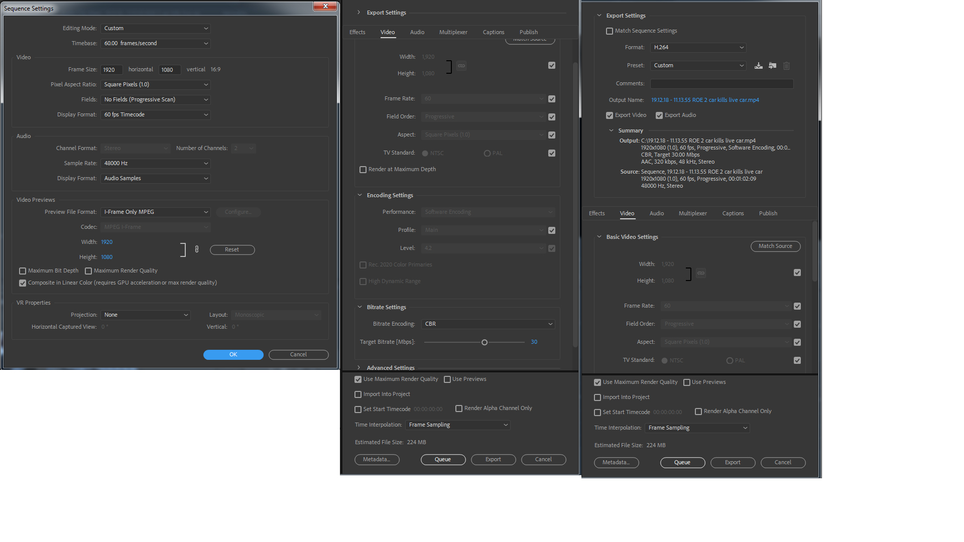

It doesn't matter if I match the sequences and settings or up them. I can't get the same result. It always gets blurred. I've searched around and people say H264 implementation in Premiere is terrible hence the result. What's your take on this? Any alternatives?
Here's the media info for both.
The source<<<<

[Attachment 47534 - Click to enlarge]
[Attachment 47535 - Click to enlarge]

CBR usually produces lower quality at a given bitrate
and you will always lose some quality if you use lossy encoding . Match settings just means match parameters like framerate, dimensions etc... , not match quality
"lossless" encoding is different, but the filesize will be much larger
But you can use x264 or x265 using the voukoder plugin
https://www.voukoder.org/
https://github.com/Vouk/voukoder -
Besides CBR, you also have set I frames only. This way if not having enough bitrate you degrade video .I frame video needs more bitrate than long GOP video.
But if using that vouk's plugin, you can select CRF mode for encoding, choosing quality and encoder distributes bitrate for you. Also I frame only settings (--keyint 1 in that plugin case for x264 encoder) is most likely not desirable for you, it balloons video size , not specifying that it will default to long GOP. -
If you think it's better, then why not use that ?
The Daniel2 H264 export uses Nvidia Nvenc to encode, so you would expect it to be definitely worse than x264, maybe even worse than the default h264 encoder (mainconcept based). Maybe you used wrong settings , or invalid testing comparison ? e.g. not similar bitrates
HEVC should give you better compression too than h264 (higher quality at a given bitrate) , you can use x265 in voukoder , or if you think Daniel2 HEVC is better, use that (It uses Nvidia Nvenc too, so you'd expect worse quality) -

Ok the run down. The target bitrate is 1080p
Adobe's h264 CBR 30k
Adobe's h264 CBR 50k
Adobe's h264 VBR 30k - 40k
These 3 look horrible by comparison with the source. Details are just not there
Daniel2 Cinergy CBR 30k - better than those 3
Voukoder h264 CBR 30k - worse than Cinergy
Voukoder x264 CRF 23 - better than everything above. Kinda close to the source
Voukoder x264 CRF 15 - better than everything above. Almost looks like the source
H264 by Adobe is crap
