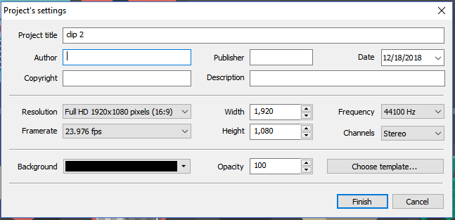

Is this a result of poorly adjusted settings when I import the MKV? Here's a screenshot of those import settings for an MKV titled "clip 2". As far as I can tell they match the original file's characteristics.
Or are there other settings somewhere else I might be overlooking or misunderstanding that I could adjust so the conversion is lossless?
Or is this one of the inherent limitations of this particular software?
