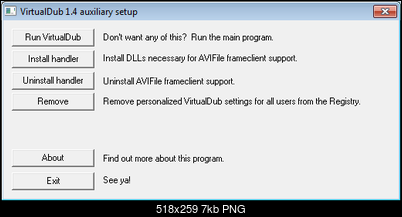

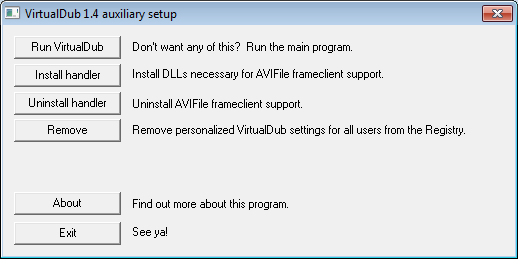

  7. You could enable LAA and therefore make 32 bit VDub use up to 4GB of memory on a 64 bit OS. Run "auxsetup.exe" in the 'extra' directory and select 'Enable LAA'.
    I don't see this option...
Name:	auxsetup.exe -- no LAA.png
    EDIT : And a Google search for : « virtualdub "enable LAA" » returns a measly two hits...
    EDIT : What's strange is that the VirtualDub2 process uses less than 2GB when it fails, according to ProcessExplorer : 1314064KB once the “A” script is loaded, and it fails when that reaches about 1750000KB – strangely Windows Task Manager reports about 1GB less).
    EDIT : After a few trials I managed to render the first of the problematic scripts. Memory usage maxed out at about 1730000 according to ProcessExplorer, and about 1236000KB (slightly increasing while the value in ProcessExplorer stalled). Why this discrepancy ?
    Only two more !

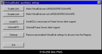

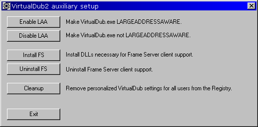

  10. Originally Posted by abolibibelot View Post
    [Attachment 47515 - Click to enlarge]
    Here's the dialog:
    Seems you are using an old VDub, not VDub2.

  12. @Groucho
    I was using VirtualDub2_41867, with the newer VirtualDub2_43073 I get this dialog indeed. Applied the patch, it seems to have done the trick : now I can load the whole “B” script which failed to load before, it's compressing right now, apparently without hiccup. Memory usage is at 3340840KB, no wonder it was starved... And 2498284KB for the “A” script.

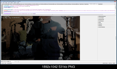

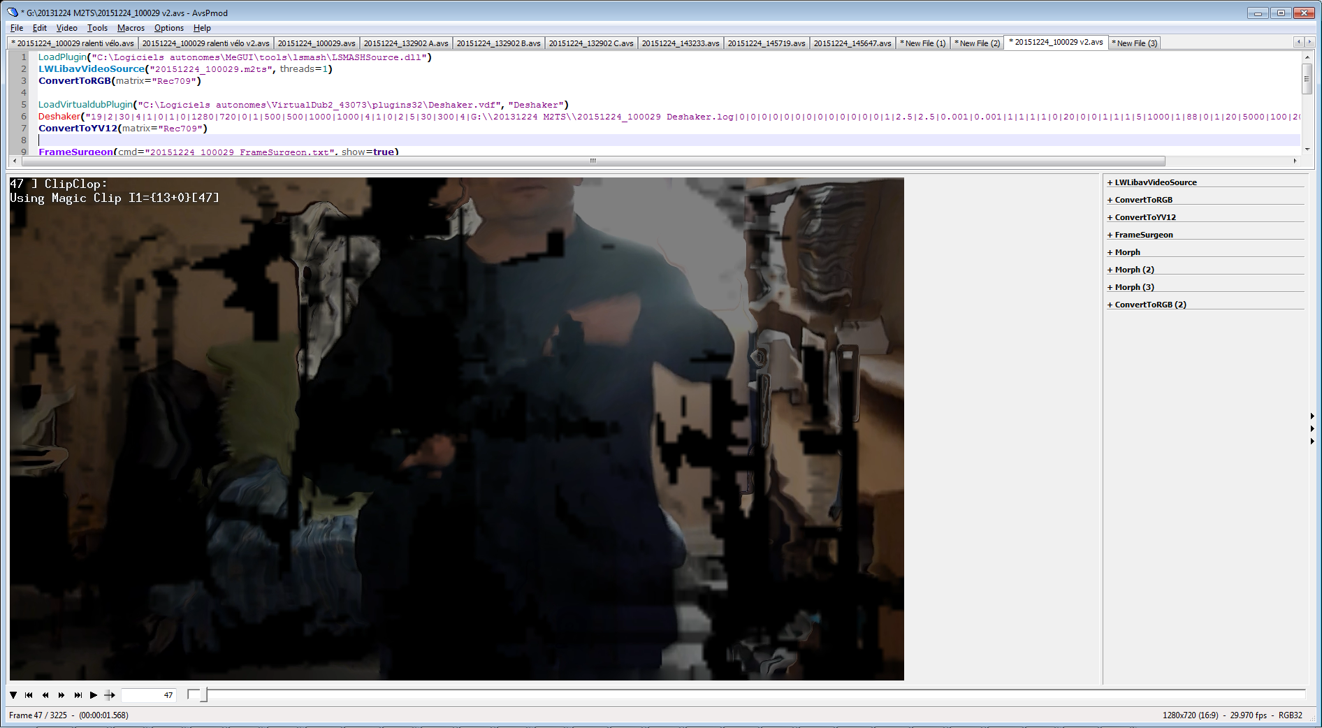

  16. Now Deshaker is giving me random black frames, which produces some funky results once interpolated by FrameSurgeon :
Name:	20151224_100029 F47 interpolation foireuse, image suivante apparaît entièrement noire.png
    (Perhaps it's dumbfounded by the horror of the suit jacket over the pyjamas...)
    I'm going to scream !

    Maybe you have too much going on there. I would split it up. Easier to debug too. Deshaker to a physical file
    But take it step by step, are you sure it's deshaker in avisynth ? Comment out the rest of the script and seek around with Lsmash only - because LSmash and transport streams can have problems too

  18. Maybe you have too much going on there. I would split it up. Easier to debug too. Deshaker to a physical file
    So one more intermediary step with an uncertain result... It defeats the purpose of running it in Avisynth, which allows to visualize the result and try different parameters before proceeding.
    Then what is the most recommended source plugin for MTS files ? Is there a chart somewhere with recommandations for each common file type ?
    And yes I checked, by placing “Return(last)” at different spots in the script. Besides, it worked fine with Depan so it's most likely due to Deshaker. Apparently it doesn't like when a frame is accessed directly, instead of linearly from the begining. Also, just tried loading the Avisynth script containing the Deshaker command into VirtualDub2 (which is now patched with “LAA”), it plays fine when moving forward, but as soon as I go back 1 frame it turns black, and stays black, and all following frames are black. The “extrapolate colors into border” feature is said to be very slow, so it might be too demanding for real-time processing, I dunno... (That's another dilemma : zooming in by a fixed factor will soften the picture and cut people's faces in some places, but trying to interpolate borders seems to produce an ugly result more often than not.)

    Right, that sounds like a non linear seek issue with deshaker in avisynth. So the KISS rule in effect here, the physical I-frame intermediate after deshaker/vdub will solve your problems
    Probably the most consistent source filter is DGSource/DGDecodeNV, but it's not free and requires a compatible Nvidia card. But it indexes the file, so it's robust , even with non linear seeks. A side benefit is offloading from the CPU . ffms2/lsmash index the file too, but they can exhibit flaky behaviour with transport streams. It's a well known issue.
    LSmash is probably ok for linear seeks, or something simple... but you have clipclop /framesurgeon there on top, that requires non linear access. It's very tough on a long GOP source, probably making a large contributing to your memory issues as well
