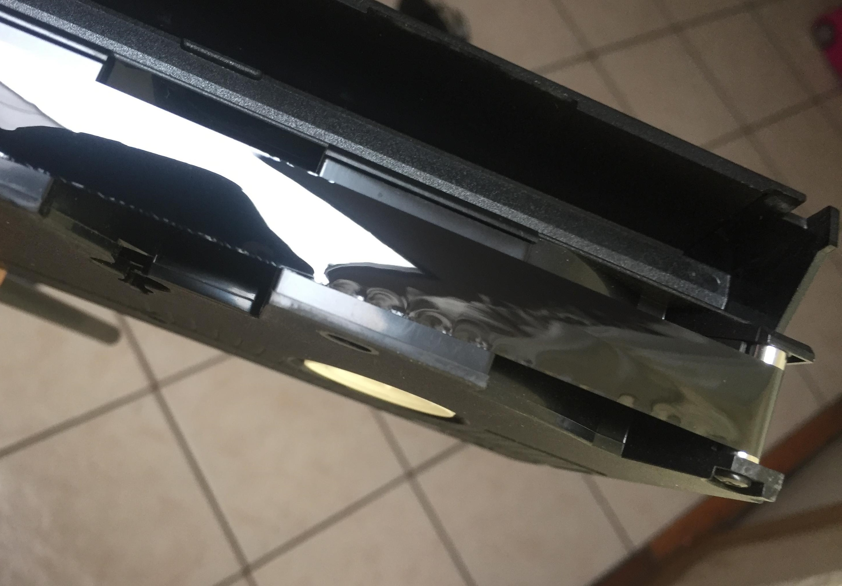

    And here is a photo of the actual tape damage:

    Doesn't look like typical mis-tracking that I've seen. More like a vertical hold look. I suppose different decks behave differently.
    But the damage is clearly in the control track area.
    Can you adjust tracking while it plays? Does it do anything?
    Does it look the same if you unplug the cable to the audio/control track head?
    Almost seems to lock on for a few seconds, rather than a continuous rolling picture.
    I wonder if you could slow the tape down a bit by putting your finger on the pinch roller or capstain? Does the image problem get worse or better? (be careful, don't want to damage the tape further. Perhaps test on a junk tape first)
    Last edited by TooOldToChange; 4th Mar 2019 at 20:22. Reason: More questions/suggestions

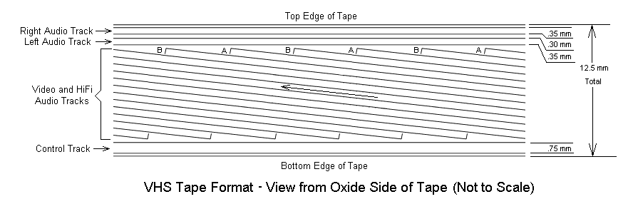

    If you look at the picture the control track and the guard bands should be close to 1mm, But it looks like there is more than 1mm damage on the tape.

  16. Agree. That's why I mentioned the damage may be more extensive than control track alone in post #31.

    We've gone thru this already, the software cannot recover anything if the video tracks are not aligned with the video heads, You have to have a proper playback of the tape first in order to fix the video signal problems, Control track pulses are not part of the video signal and the TV or an external source will never see them, They are recorded on tape by VCR's for VCR's only. Processional VCR's have an input called genlock, or external synchro, Those VCR's can ignore the control track and use an external clocked signal for the capstan servo in order to lock the video drum heads on the video tracks. and that's what I outlined in my diagram above, Kind of turning a consumer VCR into a pro one by adding an external genlock.
