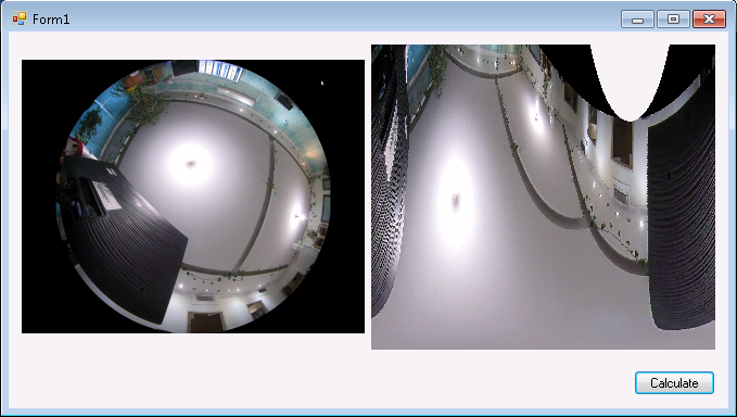

    First, let's assume that the lens has enough resolution. For making a panoramic image, I thought to map pixels in the original round image (hemisphere) to a rectangle. For this, I thought to cut the circle from its center to its bottom-side point (the vertical radius) and then calculated with the following formula which I know think has not been correct:
    private void button1_Click(object sender, EventArgs e)
    var bmp = new Bitmap(pbDest.Width, pbDest.Height);
    for (var row = 0; row < pbDest.Height; row++)
    for (var col = 0; col < pbDest.Width; col++)
    var R = bmpSrc.Height / 2.0;
    var r = R * (pbDest.Height - row) / pbDest.Height;
    var theta = 2 * Math.PI * col / pbDest.Width;
    var alpha = theta - Math.PI / 2;
    var xSrc = (int)(bmpSrc.Width / 2.0 + r * Math.Sin(alpha));
    var ySrc = (int)(bmpSrc.Width / 2.0 - r * Math.Cos(alpha));
    try
    bmp.SetPixel(col, row, bmpSrc.GetPixel(xSrc, ySrc));
    pbDest.Image = bmp;
    catch
    I know that here's not a programming forum. I just wanted you know my calculations and my approach. The result is this:
    [Attachment 47630 - Click to enlarge]
    Based on this calculations a rectangle is mapped to something like this:
    [Attachment 47631 - Click to enlarge]
    My philosophy has been mapping the center of the circle to all points of the bottom of the destination rectangle and mapping the area points of the circle to points of the top of the destination rectangle. With this philosophy, we can't reach to the rectangles shown in the YT video, especially when the rectangle is near to the center of the circle. So, it seems not to be right. I also doubt that I could implement the philosophy correctly by the code (It may need reviews).
