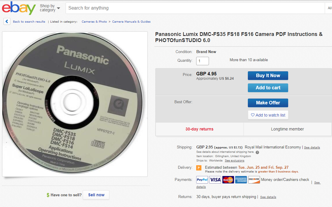

  7. @aedipuss
    might work
    Won't work because version 6.0 BD Edition is not the same as 6.0 basic edition, and for Panasonic each camera model must have its dedicated software, even though AVCHD is supposed to be a standard. And one shouldn't have to pay for something like this anyway.
