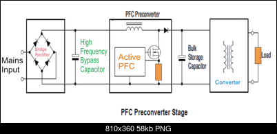

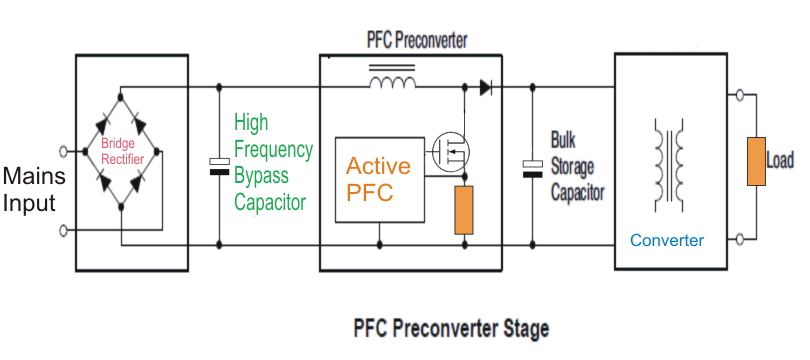

  7. Not likely if you know how PSU and UPS works internally. Of course there is always small chance that UPS is malfunctioned however statistic shows that PSU's are "weak link" devices. PSU has rectifying bridge that turns any incoming current (can be AC or DC) to DC, later there is PFC circuit and later after PFC there is proper PSU part (DC/DC converter).
    Even severely distorted power (so worst possible case where UPS produce square wave) will be converted to DC in Graetz bridge...
