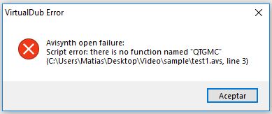

    Dec 2018
    Spain
    Originally Posted by LMotlow View Post
    Avisynth script (adjust crop and borders below for 720x480 or 704x480):
    MPEG2Source("D:\forum\VH\MGRV\VTS_01_1_sample.d2v")
    AssumeTFF()
    QTGMC(preset="very fast",FPSDivisor=2,border=true)
    Crop(4,0,-16,0)
    AddBorders(10,0,10,0)  # <- 720x480
    # AddBorders(2,0,2,0)    # <- 704x480
    Thanks!
    Just curious: I'm (still) Avisynth-illiterate. It took me a while to figure out what that script is doing, because it seemed counterintuitive that it crop 4 & 16 instead of 2 & 14 (which it makes up for in the 704 version adding 2 & 2). I suspect there's a technical reason for doing it that way?

    Anyway, I followed the steps you provided but got an error message when trying to open the file in VirtualDub. It's complaining there is no "QTGMC" function. I only got QTGMC via StaxRip, so I assumed there had to be a QTGMC.dll file somewhere that I could throw into the AviSynth plugins folder. I checked but could only find the file QTGMC.avsi under \\StaxRip\Apps\Plugins\AVS\QTGMC so I'm not sure how to fix this (I'm not even sure I should be looking for a dll at all, I'm just aping what I was told to do before with the DGdecode.dll file).
    Thanks again for your patience!

  27. The problem is StaxRip has it's own private version of AviSynth and all its filters. Other programs don't know it's there. Opening an AVS script in VirtualDub requires a system installed version of AviSynth and all the required 3rd party filters. You have AviSynth installed so you should be able to use StaxRip's versions by manually importing them with import("X:\Path\toStatxrip's\plugins\QTGMC.avs") and LoadPlugin("X:\Path\toStatxrip's\plugins\plugin.na me.dll") for each of the required dll files. Or you can copy QTGMC.AVS and any missing dll files from StaxRip's plugins folder to AviSynth's plugins folder.

    QTGMC.avsi would be a copy of the code for QTGMC, but the plugin actually requires several support plugins, a Windows system library file, and some VisualC runtimes. I don't use StaxRip except to encode occasionally but I don't use its Avisynth functions. It seems you should be able to edit the Avisynth script that StaxRip uses. If not, I'll attached a .zip file (NOTE: not attached. see EDIT and link below) of all the requirements updated as of Nov 2017, which uses the original QTGMC and is current except for some 16-bit versions of the plugin that you don't want at this point anyway. The .zip has subfolders with everything you need.
    Create a new folder or subfolder somewhere for the .zip file, then download it to that folder. When unzipped, look first at the "READ ME FIRST.txt" file.
    [EDIT] Videohelp's uploader isn't working, so use this link below for the original zip file compiled by an acquaintance of mine at digitalfaq.com:
    http://www.digitalfaq.com/forum/attachments/video-capture/6322d1467077360-vhs-capturing-qtgmc_newzip.
    When you have QTGMC and its support files you'll also have a handy bunch of popular standalone filters that are also used in several other high-octane plugins.
    Yeah, I figured what StaxRip did (not that it doesn't do a lot of other things, but what it did for me here) was pack everything I needed to use QTGMC without caring what was going on behind the scenes. But I knew AviSynth could come handy in the future, that's why I installed it separately from StaxRip. But I don't know exactly what I installed. I guess it's the basics? AviSynth itself with its own filters?
    I have zero knowledge of how scripts (or the whole frameserving process) works, so I'm lost here. But I'm willing to learn, I know it can't be that hard (I just recklessly got here doing whatever was needed to get the filter to work, and now I'm working my way back figuring things out). Do you mean (on your first suggestion) adding those lines to the script I load in VirtualDub? Would that mean having a 'template' with all the stuff I need to import every time I run a script? Sorry for the dumb questions!
    Sorry for the dumb questions part deux. Are you suggesting the same as jagabo's second suggestion, or is it a different method? Would that be copying that avsi file (converted to avs) to the proper folder, plus copying (or importing manually) what I need from StaxRip? Anyway, I'm pretty sure the best approach would be a clean install from the .zip file, which I already downloaded and will deal with later (I need to gather some morale). Let me know otherwise!
    Sorry for the dumb questions part deux. Are you suggesting the same as jagabo's second suggestion, or is it a different method? Would that be copying that avsi file (converted to avs) to the proper folder, plus copying (or importing manually) what I need from StaxRip? I'm pretty sure the best approach will be a clean install from the .zip file, which I already downloaded and will deal with later (I need to gather some morale).
    Programs like StaxRip and MeGUI that use Avisynth internally have customized their setup for their own use -- which might not always agree with the current state of a user-installed Avisynth setup. Also, the plugin support packages for QTGMC will differ for different versions of QTGMC. To date, the "safest" version of QTGMC.avsi is the "original" version 3.32. The support files in the .zip package are updates for that version. Later QTGMC versions are mostly compatible with those support files, but later versions require additional support pieces. For myself, I like playing it safe most of the time with the old "3.32" and storing updated and matching support filters in the official plugins folder. When I want to play with later and more experimental versions I have separate plugin folders for those, where I keep the new .avsi's and all of their support files, and which I explicitly load and import into a script by name and location.
    It's been so long since I used freebies like StaxRip, Avidemux, etc., I don't recall in detail how they worked. I might be confusing Avisynth usage in StaxRips with usage in MeGUI or some other ancient app, I don't remember. Meanwhile I use and update my main in-system Avisynth installation "by the book", so to speak. This doesn't interfere with the free apps, and the free apps don't interfere with my Avisynth.
    Two tips about building up Avisynth plugins:
    First, don't download plugin packages into your plugins folder. Downloads usually have a bunch of files that aren't filters and that don't belong in the plugins folder. Make subfolders for those packages so you'll know where to find spare copies and documentation. Then, just copy the .dll, the .avsi, or the .avs plugin itself into the official folder. Otherwise you'll have a huge mess on your hands.
    Sometimes a plugin in one of those packages will be older than the plugin you already have. It's safest to use the newer version. But keep the old one in a safe place. You never can tell. Sometimes the newest comes with a bug.
