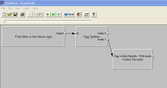

Initially this is what will appear…
yourfile.ogm -> ogg Splitter video(0)-> codec video decoder -> video
audio(1)-> vorbis decoder -> sound
Remove the video decoder, video render, stream switcher and default direct sound. Leave the vorbis decoder there.
This is what you should have at this point. (I should point out that my test movie was First Men In The Moon – how sad is that!)

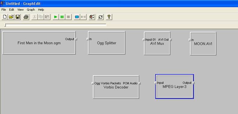

Click on the “blue rectangular” icon / filter box and choose DIRECTSHOW Filters.
Pick AVI Mux, and File Writer (that will ask you to name what your final avi file will be called – in this case MOON.AVI
You will also need to add the MP3 filter from the AUDIO COMPRESSOR filters (the final avi file would be HUGE otherwise).
Remove all connections using the icon next to the blue rectangle (best way to describe it)
Let’s now marry up those boxes as shown below..
