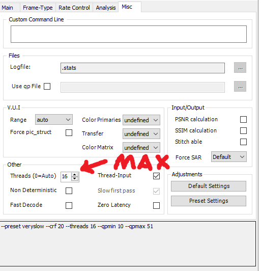

    Just one simple question. Is there any way to increase number of threads in x264? Am using MeGUI to encode and the maximum number of Threads i can set is 16. I have Ryzen 2700 and i read somewhere that i should be able to set it to more threads (8 in my case prob ... correct me if am wrong). Anyway I tried to stress my CPU as much as i can and it only work about 55% of max power. I remember on Ryzen 1700x i don't remember how but my mate overdrived this limit and from 70% it jumped to 100% (but he doesn't remember how either ). Any ideas?

  7. --preset veryslow --crf 20 --threads 16 --qpmin 10 --qpmax 51
    that's my profile and same profile i used on my mates desktop, but we had to set up more threads to make it work as it should. When i put threads more than 16 manually in profile (coz MeGUI or x264 settings exacly doesn't allow me to do it) it works the same, but when i come back to config in megui UI freaks out and i can't even enter into it. I have to set threads lower to have access to the profile from MeGUI level. Thread input is set by default, but not sure if it works with more than 1 thread (at-least it appear when i lower no of threads).

    Set the GUI Threads to 0 and put --threads 24 or whatever number in the custom command line at the top of your picture.

  14. Still the same ...
    I have SSD then yeah ... as i wrote before i don't imagine bottleneck in my case, but just option which blocks performance. On the same exacly copy of MeGUI i remember we could set it up to 20 threads in options even, but i don't remember what else he had to change to remove this cap.

    Shouldn't really matter if the GUI supports it because you can manually entering in the --threads # in the top box.

    I have no idea why you're having problems with MeGUI's custom command line. It works fine for me (I'm running a quad-core and XP). MeGUI possibly limits the thread count to 16 in the GUI, as apparently more than 16 threads can start to impact quality.
    If you're decoding with ffms2, check to see the decoding thread count isn't set to 1 in Options. Normally it's a good idea (so it's the default), but for decoding a lossless source, increasing it or setting it to zero shouldn't cause problems. Or index with LSmash instead. You're not using AviSource or DirectShowSource, are you?
    Does the command line at the bottom of the encoder configuration show what you've entered in the custom command line section? ie
    --preset slow --tune film --crf 18.0 --threads 20 --sar 1:1

    I tried two custom command lines, specifying a different number of threads each time.
    --[Information] [13/12/18 3:33:44 AM] custom command line: --threads 24
    --[Information] [13/12/18 3:33:44 AM] Job command line: "C:\Program Files\MeGUI\tools\x264\x264.exe" --preset slow --tune film --crf 18.0 --threads 24 --sar 1:1 --frames 88954 --output "D:\test.mkv" "D:\test.avs"
    --[Information] [13/12/18 3:35:48 AM] custom command line: --threads 20
    --[Information] [13/12/18 3:35:48 AM] Job command line: "C:\Program Files\MeGUI\tools\x264\x264.exe" --preset slow --tune film --crf 18.0 --threads 20 --sar 1:1 --frames 88954 --output "D:\test.mkv" "D:\test.avs"
    If for some reason that won't work for you, I think you'll find the simplest solution is to run two encodes simultaneously, even if it requires splitting an encode into halves and appending the encoded sections. You don't even have to mess with the worker rules unless you want to. You can run one encoding job by right clicking and running it in a temporary worker, and a second job by starting the job queue normally. Just remember to enable --stitchable if you want to append the encoded video.
    I found this in the changelog. The 16 thread limit in the GUI appears to have been implemented a log time ago.
    (I assume it refers to the GUI)
    0.2.4.1010
    Commit by Sharktooth:
    - Max number of threads for x264 is now '16'
