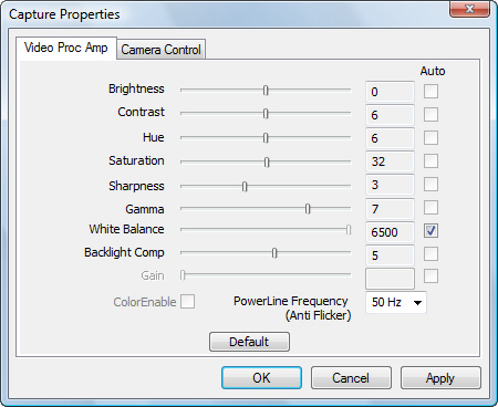

  2. The software should give you access to the video "proc amp" controls which will look something like:
    [Attachment 47443 - Click to enlarge]
    Those will allow you to adjust the brightness, contrast, hue, saturation, and more.

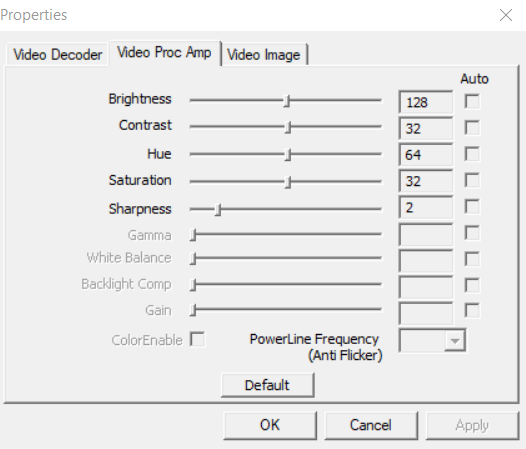

    Hm. I tried this,but unfortunately, it isn't giving me access to the white balance and others.
    [Attachment 47445 - Click to enlarge]

    Try reducing contrast and/or brightness. Best to post a sample of your capture
    for more specific advice
    Don't you know what "hue" is? I think you realize that a hue adjustment is very general and likely won't get you what you want. And if you change your mind later in the video, you'll just have to rework color all over again. That's why color is hardly ever adjusted during capture -- there are much better color controls available after capture in post-processing.
    What you should worry about most during capture is valid signal levels. Adjust brightness and contrast to avoid crushed darks and clipped highlights, which can't be corrected after capture. "Brightness" adjusts black levels, "Contrast" adjusts brights and highlights. Sharpness should stay at default. Don't try to sharpen VHS during capture: all you'll do is sharpen noise and make it worse. Sharpen later.

  6. Originally Posted by m-acrylic View Post
    If your cap is too bright you need to adjust brightness and contrast. White balance isn't related to the brightness, it's about the purity of whites and greys. Most capture devices (their drivers, at least) don't give access to the controls below sharpness.

    I tried this too, but the picture is so bright, that the picture is hard to see, so it doesn't really work.
