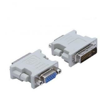

    How about getting a dvi-d to vga, Could this be supported? I dont care about the analog aspect as long as im getting the maximum 2560x1600
    The adapter is really a DVI-I to VGA adapter and cannot work for your monitor. (DVI-I has the ability to provide a VGA signal on some of its pins. DVI-D dual link is strictly digital.) Your monitor has a DVI-D dual link connection and no VGA connection.
