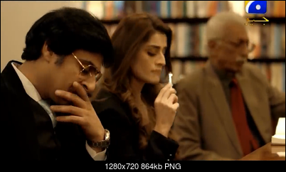

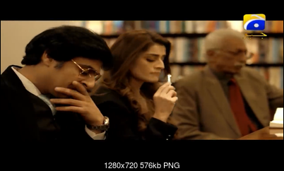

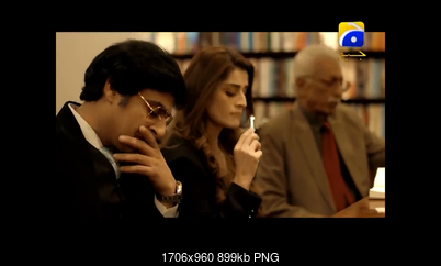

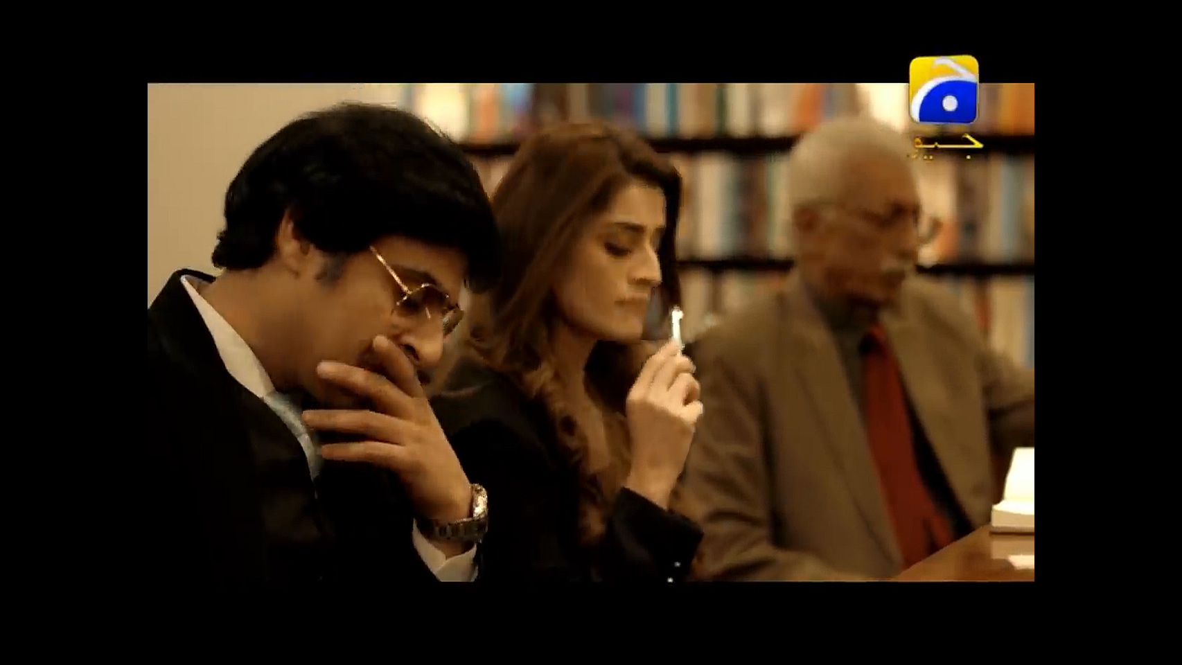

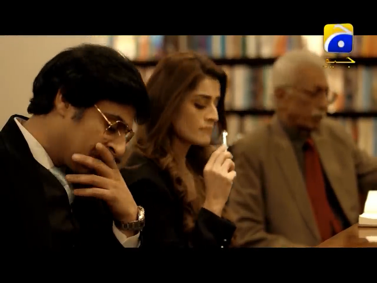

    And by the way, the aspect ratio is totally wrong... (Unless it was made in a country where people have weird wide faces and an alarming obesity rate ?) Someone added large “letterbox” black borders to the original picture which was probably shot in 16:9 ratio, generating a wildly elongated 2.37 ratio. If you really want to download that from there, you may correct this by remuxing with a 4:3 flag (with MKVToolNix or MP4Box for instance), which won't re-encode and won't affect the quality, but you'll end up with a tiny 16:9 picture with extra “pillarbox” black borders on the sides when watching it on a 16:9 screen, unless you crop the current upper and lower black borders, which means re-encoding, thus further degrading the already lousy picture quality, and ending up with a cut logo dancing in the upper-right corner...

    Thank you for pointing out those flaws in the aspect ration of the video. And also for suggesting measures to correct the aspect ratio. The methods you have advised will be quite useful to me for future in correcting aspect ratios. Yes, I know that the producers here are quite careless in maintaining the correct aspect ratio as they are not too concerned about video quality although this is an episode from a well known Tv soap opera and is watched by a large audience. But you can say people here are very unaware about video quality and the videos these tv channels put out on their youtube channels is quite crappy in terms of resolution also, not only aspect ratio. You would be aghast to see what kind of crappy quality they post, sometimes its barely 360p. But people on the other hand are also not too bothered so nobody seems to care about quality at all.
    But thanks a lot for the detailed advice.

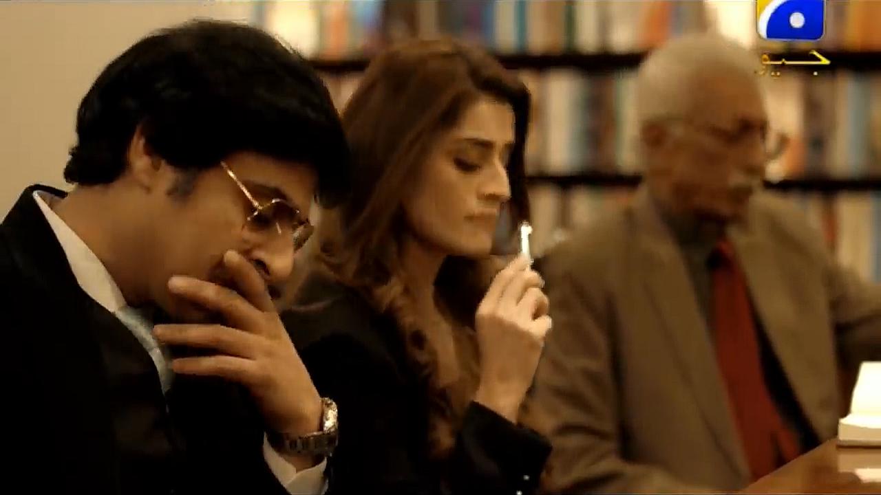

  8. By the way I played the video directly in SMPlayer (Open > URL), from France, with no proxy / VPN, and it can correct the aspect ratio during playback (Video > Aspect Ratio > 4:3) ; but it doesn't seem to have a crop option. VLC Media Player has both settings, but it won't play the video directly from the link. (I didn't even try opening it in the browser – I always dread spending 5 hours straight on YouTube when I just wanted to watch a single video ! One night, some years ago, I started watching a video of a cute kitten, then went on to get trapped for a massive two days binge watching session, stumbling upon quite horrifying things along the way, like videos about serial killers...[*]) So once you downloaded the video, you can get a decent-ish looking picture with no conversion needed by playing it with VLC and just as it starts, changing aspect ratio to 4:3 then cropping to 16:9 ; then you should be able to view it in full screen without black borders, with no need for further processing (and indeed with such a low level of quality it's not worth the time it would take to convert those videos with proper settings, as this GIF image I found the other day on that thread aptly illustrates).
