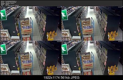

    Having finished the task which required the GAVC codec, I re-installed CCCP 32 bits, activated LAV Splitter for AVI as before, but Video Thumbnails Maker (with “Engine 2” rendering module) didn't work right away. Fiddling some more with various settings (unfortunately I don't remember the details of what I did), I managed to make it work, but now I get a blurred strip at the bottom edge of the picture, with patches of pixels moving haphazardly, and a sort of pulsation once per second. I made some tests with MPC-HC (the one included with CCCP), and Codec Tweak Tool :
    - If I disable “ffdshow video decoder” and “LAV Video Decoder” in “DirectShow filters”, I get a correct picture, but VTM fails with that setting.
    - If I disable “LAV Video Decoder” only, I get the blurred strip.
    - If I disable “ffdshow video decoder” only, the video won't start.
    - In CCCP I tried “Reset user settings” and “Repair CCCP”, to no avail.
    Apparently, VTM needs both ffdshow and LAV decoders activated. It used to work fine, so what's going on, and what setting(s) should I fix ?
    Preview picture generated by VTM / Engine 2 today (I tried several times, each time the blurred strip looks slightly different) :
Name:	Event20160816075041025.avi # 16.jpg

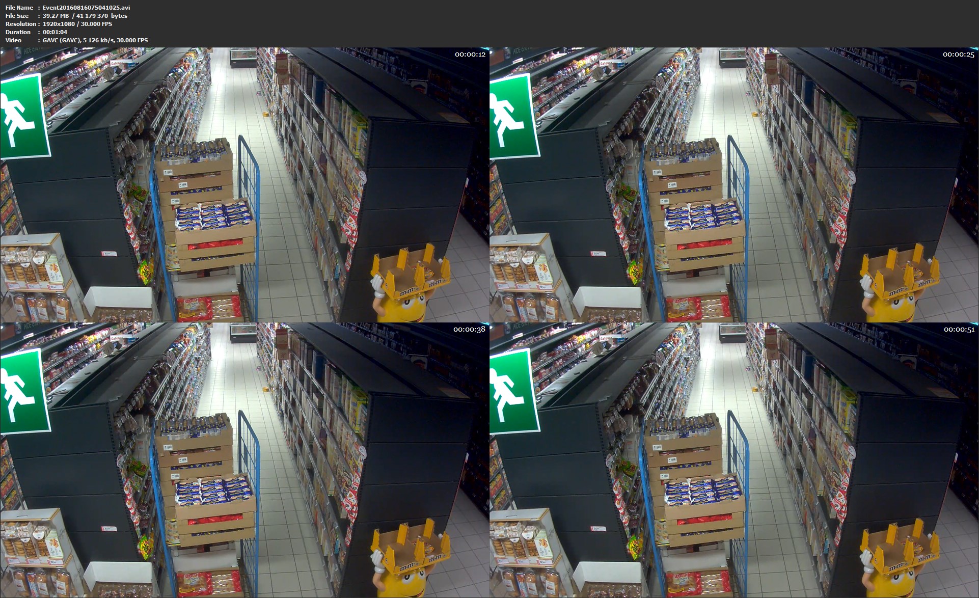

    Preview picture generated by VTM / Engine 2 on Nov. 19th, same video :
Name:	Event20160816075041025.avi {Scorp VTM module “engine 2” après installation CCCP 32 bits}.jpg
