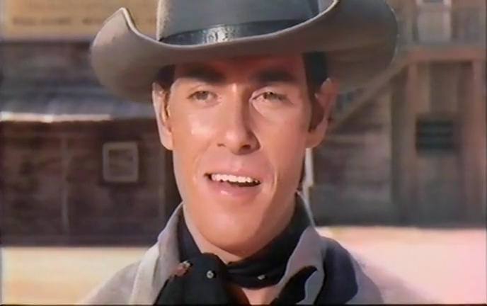

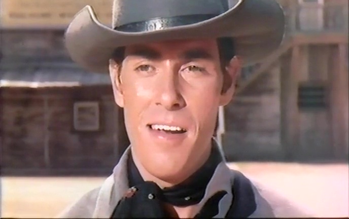

  3. The green bar at the right may be a problem with one of the filters in AviSynth. In the past some required mod16 or mod8 frame sizes. If the versions you have are very old try updating them one at a time to see if it goes away. This is true of encoders and playback decoders too.
    Color correction in AviSynth is pretty difficult. Partly because the feedback loop is slow: edit script, reload video, edit script, reload video... compared an NLE: move a slider and watch image change. And partly because of much of it working in YUV which isn't as intuitive as RGB.
    What I did for the green droop across the frame was create two videos, the original and one where the V channel was moved up 12 units. Then I used a linear horizontal gradient as an alpha channel to mix the two images together with Overlay(). The left of edges of the resulting image was 100 percent the new V, the right was 100 percent the original V, in the middle was a 50:50 mix, etc. The net result was to pull up the V channel more at the left.
    White balance can sometimes be done in RGB with RGBAdjust(). But with this video I worked in YUV. First I located a dark part of the image that I thought should be nearly black. I used VideoScope() to view the U and V channels:
    ConvertToYUY2() # videoscope requires YUY2
    VideoScope("both", true, "U", "V", "UV")
    [Attachment 47514 - Click to enlarge]
    At the top left is the dark patch from the video. The rest are graphs of the U and V channels (U increases left to right, V increases bottom to top). What you want to do is move the little white dot to where the crosshairs meet (perfect grey). In this example U needs to move about 4 units to the right (+4) and the V channel needs to move about 11 units up (+11). In the original sample I used it was 4 and 9. I did the same for the brights and ended up with two versions of the video:
    darks = ColorYUV(off_u=4, off_v=9)
    brights = ColorYUV(off_u=18, off_v=3)
    Then I blended the two videos together using an alpha mask generated from the Y channel (brightness).
    Overlay(darks, brights, mask=ColorYUV(cont_y=50))
    The end result is that dark parts of the picture get the "darks" adjustment, the bright parts of the picture get the "brights" adjustment, and parts in the middle get a weighted adjustment base on their brightness.

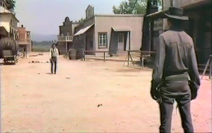

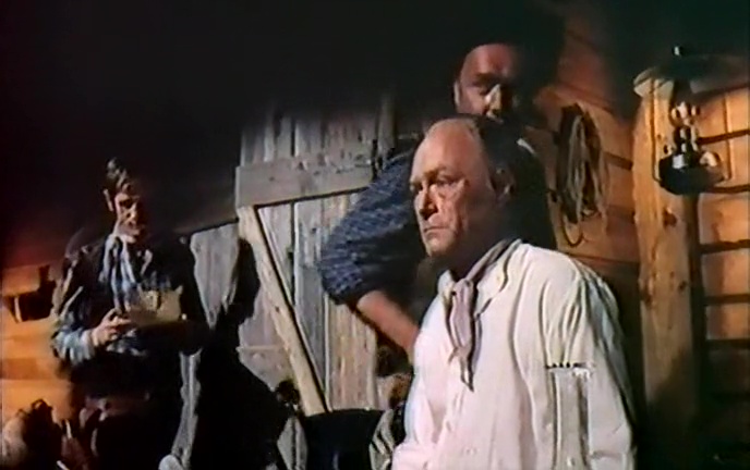

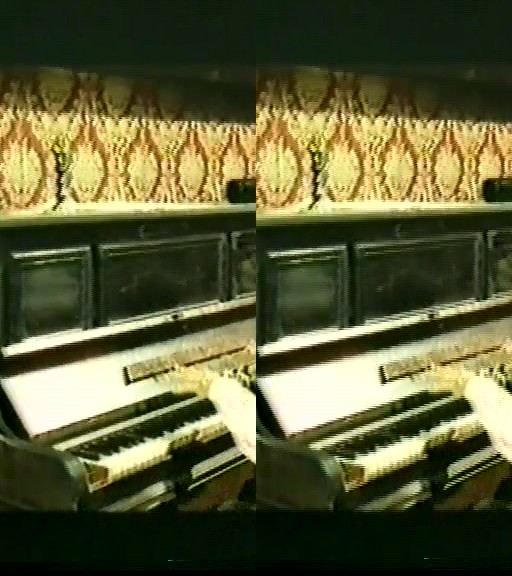

  9. So I've been trying to apply the tips in this thread to another project - an old TV recording of another western. This one was very dark and had some greenish tint to the picture. Attached is what I was able to do... just wondering if there are any tips on if I am on the right track with this or suggestions for improvement?
    Attached is a few clips joined in one video file, and the 2nd is my filtered video in side-by-side comparison.
    This one is PAL, encoded/flagged as interlaced but I don't think its true interlacing as TFM() handles it fine.
    One thing I am not sure about - in the last 2 clips where there is movement in the picture, TFM() has taken care of the combing but if you look at the bottom, there is still one horizontal line showing that looks like combing.
    Here is the code I am using for this. I have Stab commented out because I wasn't sure if I wanted to apply it, but the picture does seem to benefit from it:
    Mpeg2Source("newclips.d2v", CPU2="ooooxx", Info=3)
    TFM()
    # remove black borders
    Crop(4,78,700,-90)
    src=last
    # adjust levels, saturation, color
    Tweak(bright=2, cont=1.2, sat=1.3, hue=3)
    # antialiasing
    Santiag()
    # stabilize frame
    #Stab(mirror=15)
    #sharpen, denoise
    ConvertToYV12()
    QTGMC(InputType=1, Preset="Medium", EzDenoise=2.0, DenoiseMC=true)
    LSFMod(Strength=75)
    GradFun3()

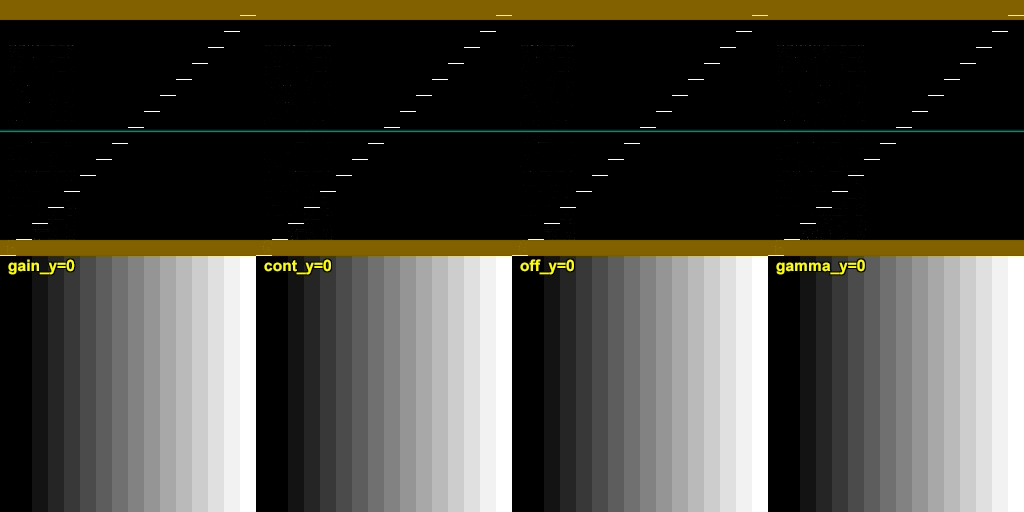

  12. Here's a similar "vary" function for ColorYUV():
    function _VaryColorYUV(clip v, string property, int value)
        (property == "cont_y") ? ColorYUV(v, cont_y=value) : v
        (property == "cont_u") ? ColorYUV(v, cont_u=value) : last
        (property == "cont_v") ? ColorYUV(v, cont_v=value) : last
        (property == "gain_y") ? ColorYUV(v, gain_y=value) : last
        (property == "gain_u") ? ColorYUV(v, gain_u=value) : last
        (property == "gain_v") ? ColorYUV(v, gain_v=value) : last
        (property == "off_y") ? ColorYUV(v, off_y=value) : last
        (property == "off_u") ? ColorYUV(v, off_u=value) : last
        (property == "off_v") ? ColorYUV(v, off_v=value) : last
        (property == "gamma_y") ? ColorYUV(v, gamma_y=value) : last
        # gamma_u not supported
        # gamma_v not supported
        Subtitle(property+"="+string(value)) #show property and value used
    function VaryColorYUV(clip v, int "frame_num", int "num_frames", string "property", int "start_val", int "end_val")
        Trim(v, frame_num,frame_num)
        Loop(num_frames, 0, 0)
        Animate(0,num_frames, "_VaryColorYUV", last,property,start_val, last,property,end_val)
    Similar calling sequence:
    VaryColorYUV(last, 300, 100, "off_u", -256, 256)
    Supported paramters are gain_y, cont_y, off_y, gamma_y, gain_u, cont_u, off_u, gain_v, cont_v, off_v. gamma_u and gamma_v don't really make sense and aren't supported by ColorYUV() -- they don't do anything.

  14. Originally Posted by autephex View Post
    It seems that just applying TFM() on this PAL version works while leaving at 25fps. I wasn't sure though if it would also be better to restore back to 23.976fps
    It's already progressive. You don't need either TFM or SRestore. If you want to return it to film speed then use AssumeFPS and slow the audio to match.
    I would like to make the black levels a bit darker/more black...
    No you don't. It's the contrast that's messed up, and it's the contrast you want to fix. I did it this way:
    Tweak(Bright=10,Cont=0.8,Coring=False)
    Others might fix it differently. It's slightly 'tilted' and you might want to use Rotate to correct that. I used:
    Rotate(-0.1)
    I got slightly different crop values than you did, and you have the additional problem of the crop values changing during different parts. I only looked at Brawl2.

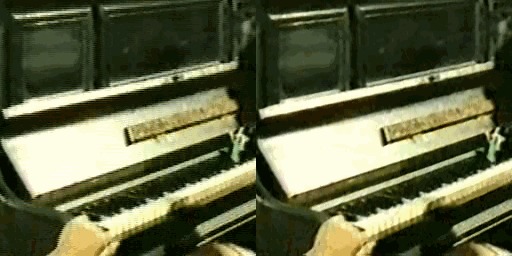

  15. I had already tried changing the contrast a bit but I figured that changing the settings of the original script where it adjusts the black and white levels would be the better way to do it. Maybe you're confused because you didn't notice the original script being used for color/brightness/contrast.
    Regarding not needing TFM, I disagree... it may not be needed for a DVD encoding but I am working on an encode that will not be DVD video.
    It is encoded as interlaced despite being progressive, and as I understand it, it needs field matching performed by TFM(). Or am I not understanding this correctly?
  16. Well I just did a test encoding without TFM and it looks like you're right... with and without TFM the encodes look identical as far as I can tell.
    I'm confused though because I thought progressive video encoded as interlaced required field matching to restore progressive. Also the original video has what looks similar to combing and I thought this was fixed by TFM() but I guess not.
    Also adjusted crop values to the following:
    Crop(22,74,-10,-70)
    Like you say, the black areas shift a bit so sometimes it moves into the frame slightly with this value. May add a resize to get true 16x9 or could crop vertically a bit more for 688x387 which would be true 16x9, but would crop out a bit of the frame
  17. Originally Posted by autephex View Post
    I'm not 'confused', but you're right in that I checked nothing but the first M2V of the four you uploaded and only your previous post. However, you also mentioned not understanding ColorYUV and I corrected the contrast using the easier-to-understand Tweak.
    You thought wrong. If the content is progressive, no matter how it's encoded, then treat it as progressive to begin with. This is a common problem people have - not understanding that there's often a difference between the content and how it's encoded.
    ...could crop vertically a bit more for 688x387 which would be true 16x9, but would crop out a bit of the frame
    AviSynth won't let you do that as all crops must be in multiples of two (at least, depending on whether or not the content is really interlaced). There are a number of ways to handle different crops for different parts of a video. You could crop the different parts differently followed by resizing those different parts to the same resolution. Then join them all together. That's one way, but one would have to see the whole thing (not asking for it to be uploaded) to make a decision because some of it will have a very slightly wrong aspect ratio. You want to avoid cutting into the active video as much as possible, even with crap DVDs such as yours.
  18. I didn't mean that you're confused about what you're doing, only that you missed that I was still applying the previous script by jagabo on the current video. This is why I mentioned using his original method with ColorYUV regarding the levels, because he already did an excellent job with the colors/levels but I think it could just use some slight tweaking regarding the darks/blacks. His work looks much better than simple Tweak adjustments...
    I do understand there's a difference between content and what its reported as in flags, etc, but I've read several threads where posters here even have stated that actually progressive footage which is encoded as interlaced still needs field matching (when it does not display the usual interlaced combing)....

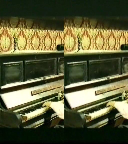

  19. I think I figured out why I was confused about the progressive/interlaced thing... the other video I'm working on right now, which I posted 2 clips from above ( newclips.demuxed.m2v, barclips-muxed.mp4) is also pal/progressive and encoded as interlaced. But it actually has combing present and TFM() field matching removes the combing.
    This one though does not seem to have the combing present, although I initially thought it did but I guess I'm just seeing jagged edges or something.
    so here's the full script I am running right now:
    import("C:\Program Files (x86)\AviSynth 2.6\plugins\TemporalDegrain.avs")
    import("C:\Program Files (x86)\AviSynth 2.6\plugins\Ramp.avs")
    import("C:\Program Files (x86)\AviSynth 2.6\plugins\Santiag.avs")
    import("C:\Program Files (x86)\AviSynth 2.6\plugins\Stab.avs")
    Mpeg2Source("grave.d2v", CPU2="ooooxx", Info=3)
    Crop(22,74,-10,-70)
    src=last
    # fix droop of V channel at left
    ramp = GreyRamp().BilinearResize(width, height)
    Overlay(last, ColorYUV(off_v=-12), mask=ramp)
    # adjust levels
    ColorYUV(gain_y=-20, gamma_y=50, off_y=-2)
    # white balance darks, brights
    # increase saturation, maybe too much
    ColorYUV(cont_u=30, cont_v=30)
    # make reds less orange, set contrats a bit darker
    Tweak(hue=5)
    # remove residual combing from bad time base, AGC, compression
    vInverse()
    # antialiasing
    Santiag()
    # stabilize frame
    Stab(mirror=15)
    # edge stabilization
    QTGMC(InputType=1)
    # chroma noise reduction, sharpen, shift
    MergeChroma(last, TemporalDegrain().aWarpSharp(depth=10).ChromaShift(c=-2, l=-4))
    GradFun3()
    #splitscreen A/B
    #left=last
    #right=Mpeg2Source("grave.d2v", CPU2="ooooxx", Info=3).Crop(22,74,-10,-70)
    #StackHorizontal(left,right)
  20. Actually, upon checking the rest of the video again, TFM() is indeed needed

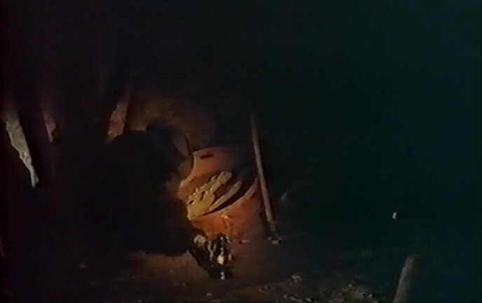

    If you look at the cabin clip, you can see what I'm saying if you apply TFM() versus without it:
  21. What I've figured out so far regarding the dark levels & contrast is adjusting the following line:
    #originally gain_y=-20
    ColorYUV(gain_y=-50, gamma_y=50, off_y=-2)
    This helps with scenes where there is some noise showing in the blacks and where its too bright. Here are some screenshots showing some of the scenes that had problems with the original settings - one shot with gain_y=-20 and comparison shot with gain_y=-50 .... its more noticeable in the actual video than screenshots. The daytime scene also shows some of the coloring problems that may need individual scene tweaking
  22. The video does switch between in-phase and out-of-phase fields. So some frames look progressive, some interlaced. TFM() takes care of that, aside from some residual combing from horizontal time base jitter. But there is uet another problem with the fields. Even when they are matched properly sometimes one field is sometimes in the wrong position. Here I have cropped the frame and displayed the original frame on the left and the result of a FieldSwap() on the right. Be sure to view the images full size or zoomed.
    [Attachment 47670 - Click to enlarge]
    The fields are in the correct position on the left, and swapping them makes the picture much worse on the right. But a few frames later:
    [Attachment 47671 - Click to enlarge]
    The original frame has the fields in the wrong position, and swapping them looks much better (though still not great, something like a dup field deinterlace). This happens throughout the four clips, alternating every few frames, with a cycle of about 6 frames.
    Because of this I think you'll be better off using QTGMC() instead of TFM().
    [Attachment 47672 - Click to enlarge]
    Thats TFM() on the left, QTGMC(preset="fast", FPSDivisor=2, sharpness=0.6) on the right.
  23. Interesting.. that's some crazy stuff that a video ends up in such conditions
    I agree with you that QTGMC looks better

  29. Here's a sample script that might help you understand what ColorYUV does:
    function GreyRamp()
       black = BlankClip(color=$000000, length=256, width=1, height=256, pixel_type="RGB32")
       white = BlankClip(color=$010101, length=256, width=1, height=256, pixel_type="RGB32")
       StackHorizontal(black,white)
       StackHorizontal(last, last.RGBAdjust(rb=2, gb=2, bb=2))
       StackHorizontal(last, last.RGBAdjust(rb=4, gb=4, bb=4))
       StackHorizontal(last, last.RGBAdjust(rb=8, gb=8, bb=8))
       StackHorizontal(last, last.RGBAdjust(rb=16, gb=16, bb=16))
       StackHorizontal(last, last.RGBAdjust(rb=32, gb=32, bb=32))
       StackHorizontal(last, last.RGBAdjust(rb=64, gb=64, bb=64))
       StackHorizontal(last, last.RGBAdjust(rb=128, gb=128, bb=128))
    GreyRamp()
    PointResize(16,height).PointResize(width,height)
    ConvertToYV12(matrix="PC.601")
    v1 = VaryColorYUV(last, 1, 100, "gain_y", -256, 256)
    v2 = VaryColorYUV(last, 1, 100, "cont_y", -256, 256)
    v3 = VaryColorYUV(last, 1, 100, "off_y", -256, 256)
    v4 = VaryColorYUV(last, 1, 100, "gamma_y", -256, 256)
    StackHorizontal(V1,v2,v3,v4)
    TurnRight().Histogram().TurnLeft()
    At frame 50 is the untouched video. Frame numbers lower than that show the result of negative values to ColorYUV. Higher frames numbers show the result of positive values.

  30. Feeding a videoclip into your sample script is indeed pretty helpful! The original with the greyramp is also, but seeing a video frame being altered explains a lot
