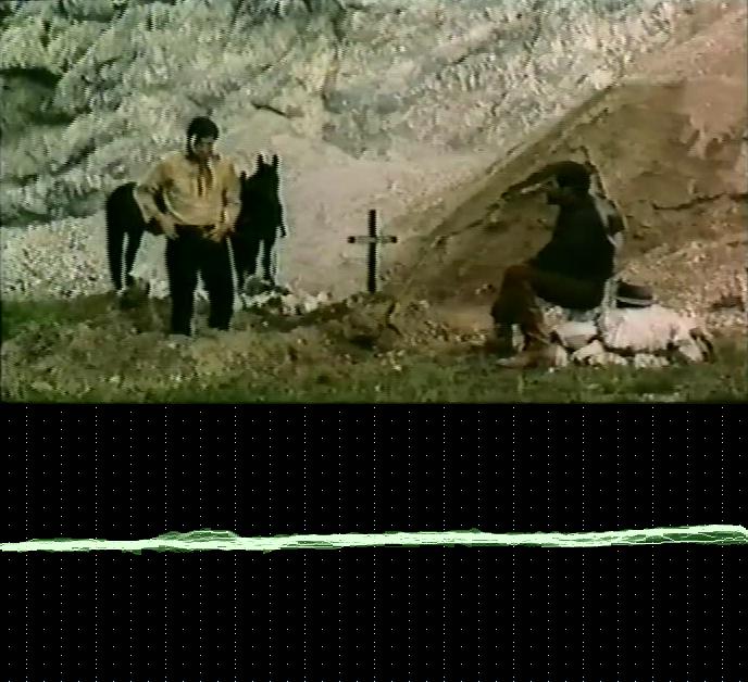

  4. I agree with the others. If you want the best results you need to capture the video again with a lossless codec. You need a line time base corrector to get rid of the horizontal jitter (this can't be fixed after capturing) and you need to adjust levels to keep darks and bright from being crushed. You also want to use a VCR that doesn't add those strong oversharpening halos.
    But one issue I saw that may be on the original tape: the V channel appears to rise across the frame causing the left to have a green cast:
    [Attachment 47400 - Click to enlarge]

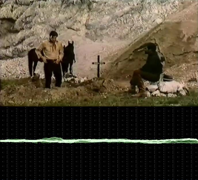

    After compensating for this we get:
    [Attachment 47401 - Click to enlarge]
    Obviously, more work need to be done on the colors but regular color filters won't fix this droop of the V channel.
    This fix was performed with:
    # open, ivtc, crop video, then
    ramp = GreyRamp().BilinearResize(width, height)
    Overlay(ColorYUV(off_v=12), last, mask=ramp)
    where GreyRamp() is:
    # produce a 256x256 ramp from black to white across the frame
    function GreyRamp()
       black = BlankClip(color=$000000, length=256, width=1, height=256, pixel_type="RGB32")
       white = BlankClip(color=$010101, length=256, width=1, height=256, pixel_type="RGB32")
       StackHorizontal(black,white)
       StackHorizontal(last, last.RGBAdjust(rb=2, gb=2, bb=2))
       StackHorizontal(last, last.RGBAdjust(rb=4, gb=4, bb=4))
       StackHorizontal(last, last.RGBAdjust(rb=8, gb=8, bb=8))
       StackHorizontal(last, last.RGBAdjust(rb=16, gb=16, bb=16))
       StackHorizontal(last, last.RGBAdjust(rb=32, gb=32, bb=32))
       StackHorizontal(last, last.RGBAdjust(rb=64, gb=64, bb=64))
       StackHorizontal(last, last.RGBAdjust(rb=128, gb=128, bb=128))
    I think there's a similar issue vertically but it's hard to tell with this clip.

    src=last
    # fix droop of V channel at left
    Overlay(last, ColorYUV(off_v=-12), mask=ramp)
    # adjust levels
    ColorYUV(gain_y=-20, gamma_y=50, off_y=-2)
    # white balance darks, brights
    darks = ColorYUV(off_u=4, off_v=9)
    brights = ColorYUV(off_u=18, off_v=3)
    Overlay(darks, brights, mask=ColorYUV(cont_y=50))
    # increase saturation, maybe too much
    ColorYUV(cont_u=30, cont_v=30)
    # make reds less orange
    Tweak(hue=5)
    # remove residual combing from bad time base, AGC, compression
    #vInverse()
    # antialiasing
    Santiag()
    # stabilize frame
    Stab(mirror=15)
    # edge stabilization
    QTGMC(InputType=1)
    # chroma noise reduction, sharpen, shift
    MergeChroma(last, TemporalDegrain().aWarpSharp(depth=10).ChromaShift(c=-2, l=-4))
    LanczosResize(704,396)
