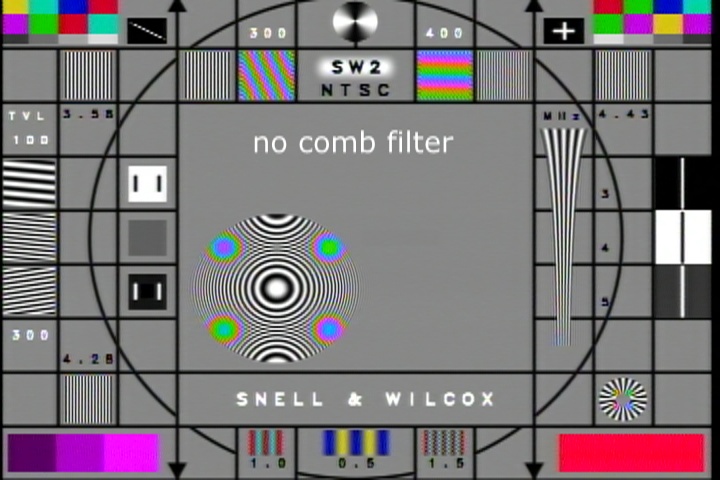

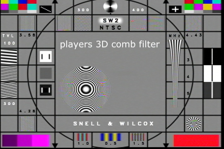

    I admit I don't get any checkerboarding when there is no comb filter in the mix, but check out the attached pix. You will notice nasty rainbows in boxes 300 and 400, and the orb when there is no comb filter. I'm still searching for the ultimate 3D comb filter. My Toshiba dvd recorder gives pretty good results on the test pattern, and has the least amount of checkerboarding so far.

    I've have stumbled on that page by Allan Jayne Jr., very good info there. I've also read a good review on comb filters at "sapereaumdesa.ga" NTSC Decoding Basics (part 4) Extron
Name:	comb filter.jpg
Name:	no comb filter.jpg
