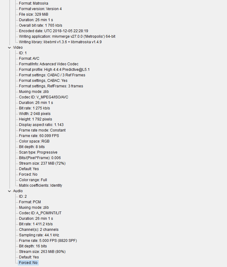

    What could be the reason for this? Maybe I just don't have enough horsepower to play this video smoothly?
  2. Probably not enough horsepower to decode 4K h.264 video at 60 fps and downscale it to 1600x900 for display. Try using a different output device (not madVR).
    Don't be fooled by the CPU model name. An i7 7500U is about equivalent to a i3 in a Desktop.
  3. Yup, the gpu (https://en.wikichip.org/wiki/intel/hd_graphics_620#Hardware_Accelerated_Video) doesn't support 'High 4:4:4' AVC and the cpu is way to slow to handle such content. (I doubt not using madVR will really make a difference, but it might be worth a try)

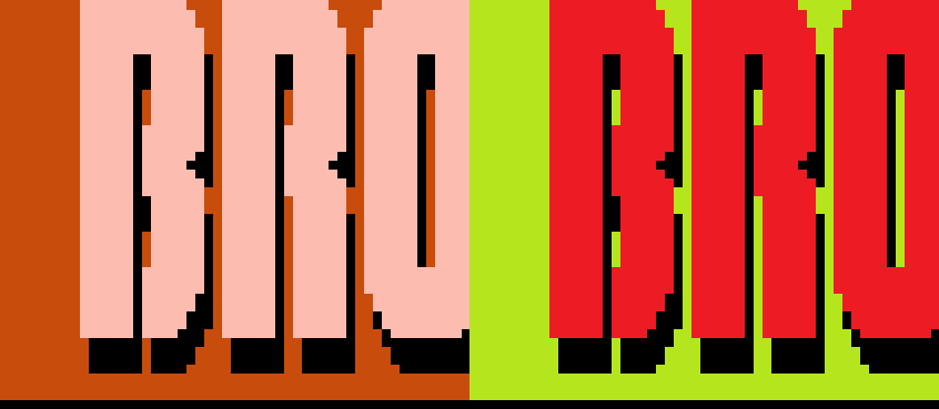

    Left is a random video frame as it shows in the video, and right was photo-shopped so you can see the color bleeding more clearly. It only happens when the filter is disabled.
    RGB 4:4:4 would not have chroma subsampling like that. That's probably some YUV.

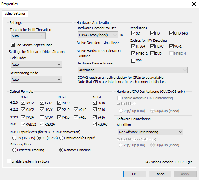

    - LAV Video Decoder (internal)
    - LAV Audio Decoder (internal)
    - LAV Splitter Source (internal)
  14. So either way it's using LAV Video?
    I still don't really get your comments about chroma subsampling with an RGB source.
