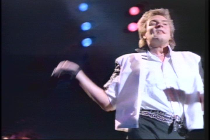

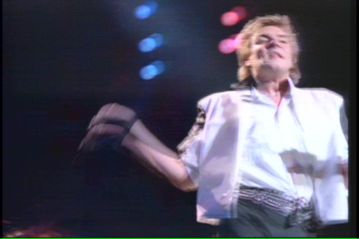

    Field blended frame rate conversions are very easy to detect. Just apply a simple bob and look for frames that look like double exposures:
    blended:
    [Attachment 47378 - Click to enlarge]
    it's a double exposure of the field before:

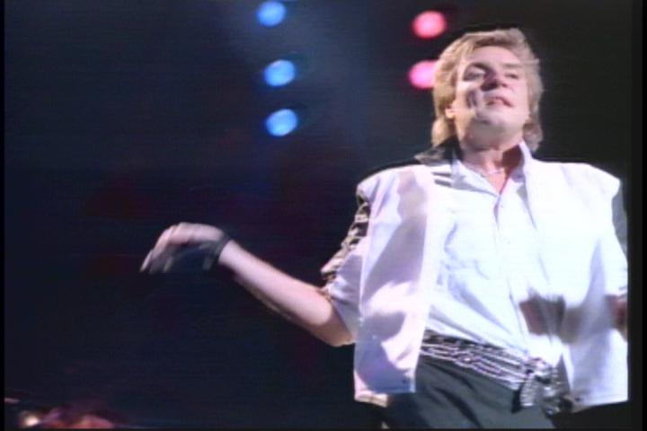

    and the field after:
    [Attachment 47380 - Click to enlarge]

    You'll see the frames alternate between clean and blended. The amount of blending will vary depending on the timing.
