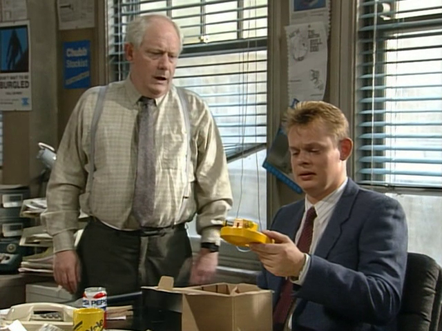

    One of the first times I've seen QTGMC mentioned was in this thread, which contains a few samples comparing it with Yadif :
    https://forum.videohelp.com/threads/354092-Converting-video-frame-rates

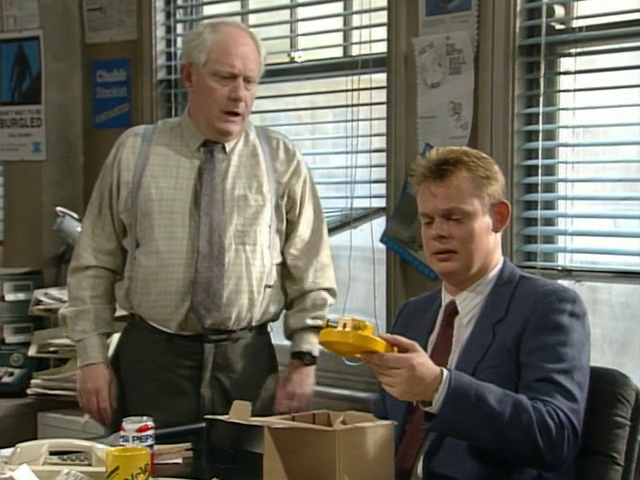

    Yadif :
Name:	Yadif 25fps.mkv.png
    QTGMC :
Name:	QTGMC 25fps.mkv.png
