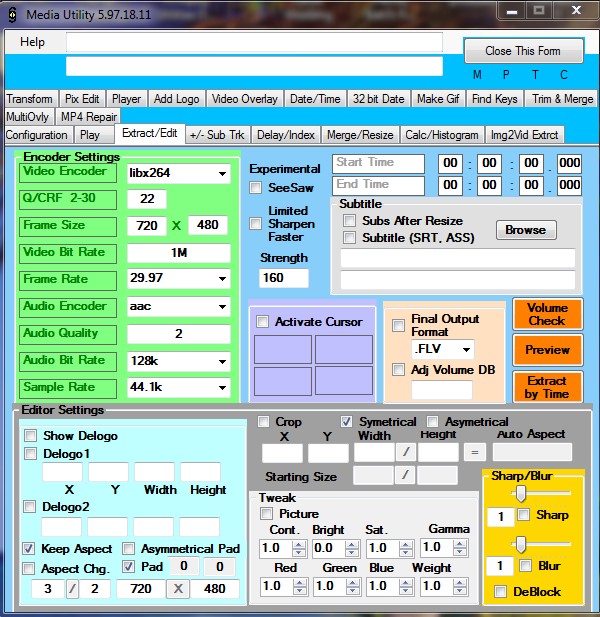

Gui Creation:
I can't arrange or design a Shower curtain to look nice so the layout sucks, I know, but It's Gui, calls any external program you want to use without actually compiling the external utility and was created with Visual Basic.
[Attachment 47398 - Click to enlarge] -
