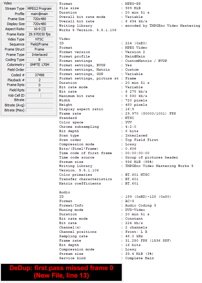

    Media-info:
    https://paste.ee/p/Pa0m3

    what are the specs of your source? You could start by providing a mediainfo report in text view.
    Is it a Hollywood movie (which would typically be 24 fps) ?
  4. redwudz Thank you for your suport, my bad.
    davexnet media-info add.
    I can not explain what you have with this DVD. It is interlaced, but when I put it in dgindex, the result is "progressive". As you can see, the sample was obtained using dgindex, but it is interlaced as it should be looking at the source.

  18. This DupMC filter does not work here. Occurs: "Module not found. Install missing library". I have tried several solutions here in the forum and it does not work. :/
  19. You just need to put dup.dll in AviSynth's plugins folder. Or manually import it into your script with LoadPlugin(). I'm using version 0.17.
    http://akuvian.org/src/avisynth/dedup/
  20. I tried this earlier.
    I'm using that same version.
    I have no idea what it is.
    I'll leave this DVD.
    Thanks for your patience.
  21. Did you install the Microsoft runtime libraries liked to at the bottom of the dedup page?
    http://akuvian.org/src/avisynth/dedup/msvc_dlls.zip
    They go in c:\windows\syswow64 if you are running 64 bit Windows, c:\windows\system32 if you are running 32 bit Windows.
  22. jagabo
    When you mentioned about the sys64 and 32 folders, I remembered that with a QTGMC filter I needed them both to work.
    I had just placed it in the sys64 folder.
    Well, the filter works, but still has an error with this Dedup accuses "first pass missed frame 0".
    Anyway, thanks for trying to help me. This video has already surpassed my patience.
    I generated a remux on the pavtube (the only one that worked fine in reading the dgindex) and I'll try some more things.

    Do you realize it is a two step process? You first run the script with just DupMC and play it from beginning to end (this generates the log file). When done you run the script with DeDup instead. So first open this script in VirtualDub and use File -> Run Video Analysis Pass:
    import("C:\Program Files (x86)\AviSynth\plugins\ReplaceFramesMC.avs")
    Mpeg2Source("01.demuxed.d2v", CPU2="ooooxx", Info=3)
    Interleave(TFM(field=1), TFM(field=0)) # smart bob
    Trim(0,599)
    DupMC(log="01.dup_list.txt") # use this to build the log file, or the next file to remove all the dups
    Then run the full script given earlier.
