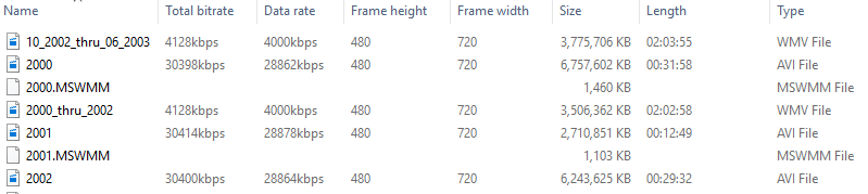

  1. Background - I have been transferring home videos from various sources (MiniDV and Phone) to my computer and adding into MovieMaker and Corel Visual Studio for creating family movies.

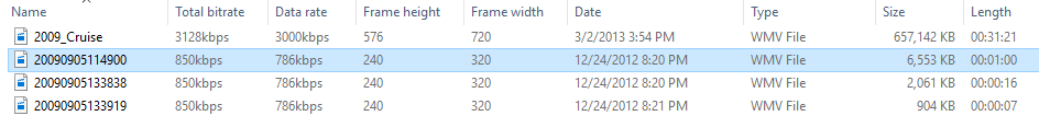

    It seems when I look at the details (file format, bit rate, data rate etc) for each of the video files, the specs vary widely. Ultimately, what I am trying to accomplish is to create a movie for each year that I can store on a external SSD drive and watch on our big screen TV. I want to create the movies in a format which is viewable in the future.
    My questions:
    1) Assuming the file format of the original files are fixed, it seems then that whatever output file format I choose when creating my movie in VisualStudio can't be any higher resolution than the input files. See 1999_example1 image for example. The file "1999 Smokey Mountains 2009_01_01...." in WMV format was taken from a MiniDV. It has a data rate of 4000kbps. When I created the AVI file from VisualStudio, it has a data rate of 28923kbps. Should I have just stayed with the datarate and bitrate of the input file? Is there any benefit of going with a higher data rate and bit rate for the output file if the input file has lower rates?

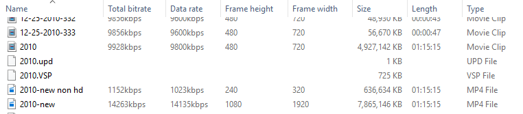

    2) For long term viewing capability, what is the best video format to use for my movies? I started with AVI and the files were rather large. Would it be better to go with another output file format for the movies? If so, can someone make a suggestion? See example 2010_example4. I tried MP4 format both standard and HD. The input file 12-25-2010-333 was 9856kbps and the 2010-new output file (HD) (created from VisualStudio) is 14263kbps whereas the 2010-new non hd file is 1152kbps. It seems the HD video was much higher datarate than the input file and the non-HD datarate was much lower than the input video file.
