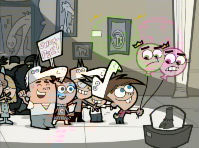

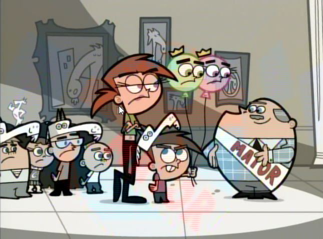

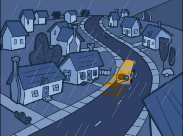

    If I use the built-in IVTC script in StaxRip (Telecide(guide = 1).Decimate()) the output is mostly OK, but has some interlacing:
    If I use the TFM/TDecimate code, there is ghosting and interlacing everywhere:

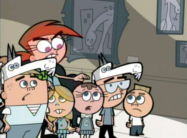

  2. I don't think I see any of that. A simple:
    MPEG2Source("Test.d2v")
    TFM().TDecimate(Mode=1)
    seems fine. Perhaps you have the wrong field order in the uncut episode? A few of the scene changes look funky, but I got this with the script above:

    I used your code, still got the same thing:
    It's Top Field First
