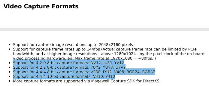

    Your magewell is upsampling from 4:2:2 to 4:4:4 there is no benefit to it other than extra large files.

    I highly doubt that, HDMI HD source maybe, but S-Video @ 4:4:4 give me a break, It doesn't even do 4:2:2 @ 10 bit only 8 bit. But hey if you can confirm it I will get one.
    Edit:
    I just looked at the manual for the Magewell card and it states this:
    Support for 4:2:2 8-bit capture formats: YUY2, YUYV, UYVY
  14. I don't know if this is pertinent, but the Pro Capture HDMI Spec shows these capture formats supported. I can't tell if some of these might be HDMI only:
    [Attachment 52981 - Click to enlarge]

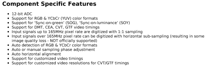

    For Component, the Spec states:
    [Attachment 52983 - Click to enlarge]

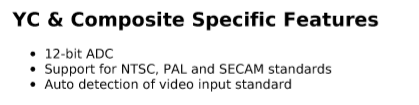

    For s-video (my method), the Spec states:
    [Attachment 52984 - Click to enlarge]
    I actually captured V410 via s-video, but I don't know if it was "natively" captured.
    On another note, the expanded list of Component-Specific features makes me wonder if I should be capturing via Component. Unfortunately, I don't have an 8mm playback device with component output. Would an s-video to component converter be of any benefit?
    Update: After some research, it looks like an analog 8mm playback device with component output doesn't exist.

    S-Video and composite will be one of these YUY2, YUYV, UYVY. There is no benefit from converting S-Video to component other than convenience.

  20. Member Cornucopia's Avatar
    Don't be led astray by anecdote. Formats like YUV, YV12, etc ARE component. Every modern digital file format is component, either RGB-based or YUV-based. Digitizing/capturing an analog signal always includes a stage that separates the elements into their components prior to encoding & saving.
    Whether it is beneficial to you to do it externally in analog land prior to digitization, or during digitization will depend on the relative quality of the comparative workflows and devices. Iow, if the analog composite/svideo to component converter is better quality along with a component digitizing card vs. a reasonable composite/svideo-accepting digitizing card with a medium quality component separator stage, then you might be better off that way. But since those 2 combinations are rarer and/or more expensive (because they are geared towards pro equipment), odds are that you will find a better setup the normal way that does not pre-separate, because an integrated consumer setup is often more optimized than 2 disparate consumer-grade devices thrown together.
