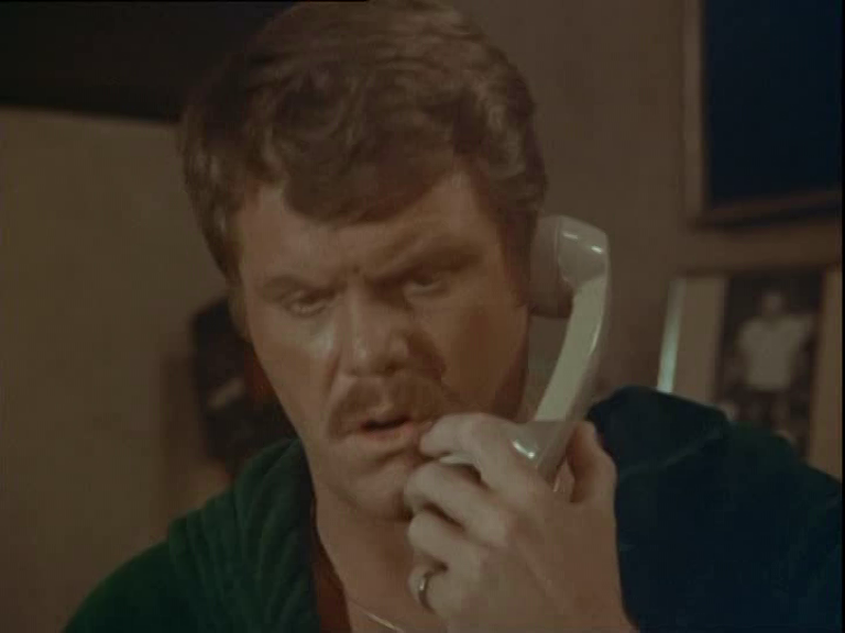

    Using DVD Rebuilder Pro V1.28.2 and tried using HC, CCE, and PC encoders. Also tried using DVDFab V9.3.1.0.
    Basically, DVDFab produced excellent results! But DVD Rebuilder produced poor results with the HC encoder giving the worst result and the PC encoder giving the best result but still not quite as good as the DVDFab result!?
    [Attachment 47225 - Click to enlarge]
    Original DVD9 screenshot

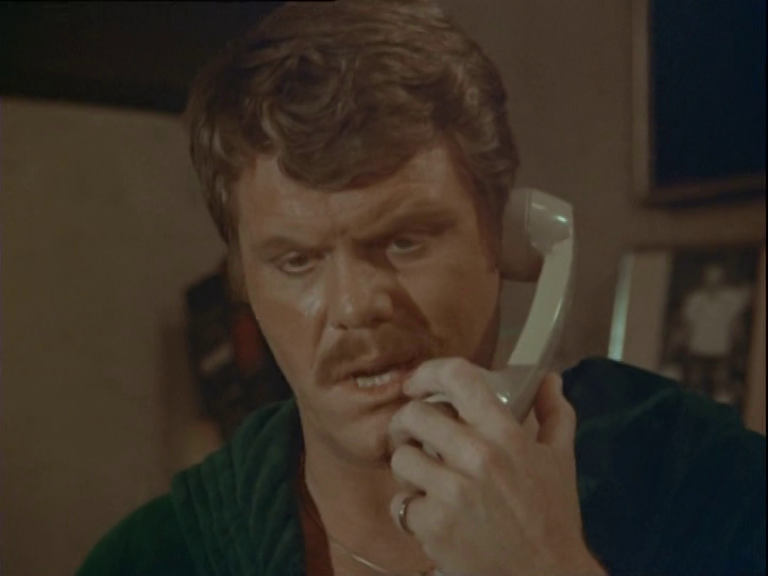

    [Attachment 47226 - Click to enlarge]
    DVD-RB DVD5 output using HC V0.23 encoder at BEST setting

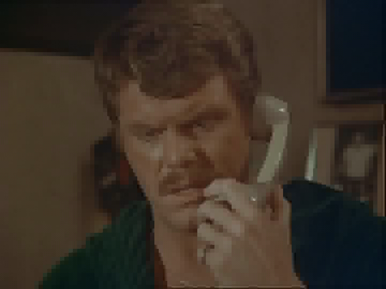

    [Attachment 47227 - Click to enlarge]
    DVD-RB DVD5 output using CCE SP2 encoder at (default) 2 passes setting

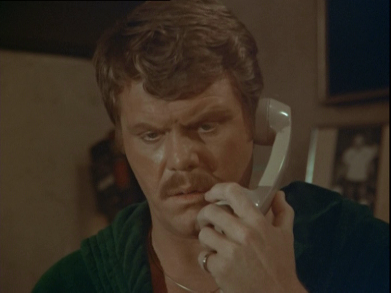

    [Attachment 47228 - Click to enlarge]
    DVD-RB DVD5 output using PC V2.04.02.0 encoder at MASTER setting

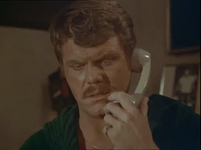

    [Attachment 47229 - Click to enlarge]
    DVDFab DVD5 output

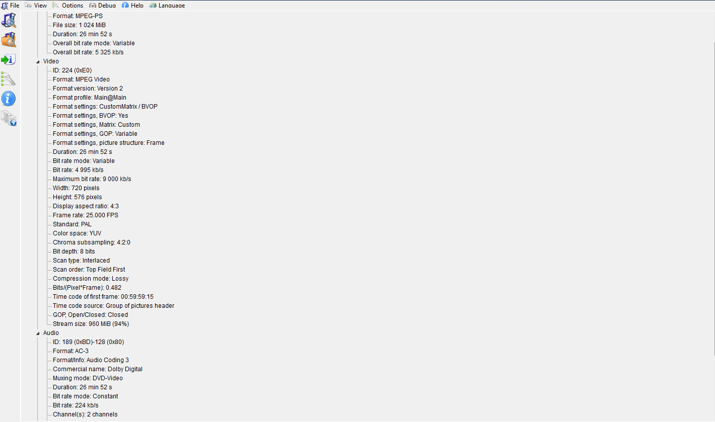

    [Attachment 47230 - Click to enlarge]
    Original DVD9 video details as per Media Info

    Looks like the rebuilder is picking 400kbps for the bitrate. This is far too low for DVD, no wonder
    it looks poor. I'm not familiar with the program, but somewhere there must be a place to control it.

  10. In the process of trying to find the best way of making sample videos of the videos in question, I found out what was causing the poor re-encodes!
    The original DVD9 files were extracted from an ISO to a test directory. The test directory also contained VOB files which were compressed as a test and the compressed files were renamed. The original VOB files were left untouched/unmodified. It seems that DVD Rebuilder also "read" these compressed files which interfered with the normal operation of DVD-RB; this lead to low bitrate conversions.
    After deleting the files in the test directory and re-copying the original DVD9 files to the test directory, those files were now re-encoded correctly with bitrates somewhere around 2700 Kbs! Much better result for all three encoders (HC, CCE, and PC)!
    So it appears that there shouldn't be any other files (especially anything that is even remotely a video specific file type?) within the source directory, otherwise these other files may interfere with the correct functioning of DVD-RB.
