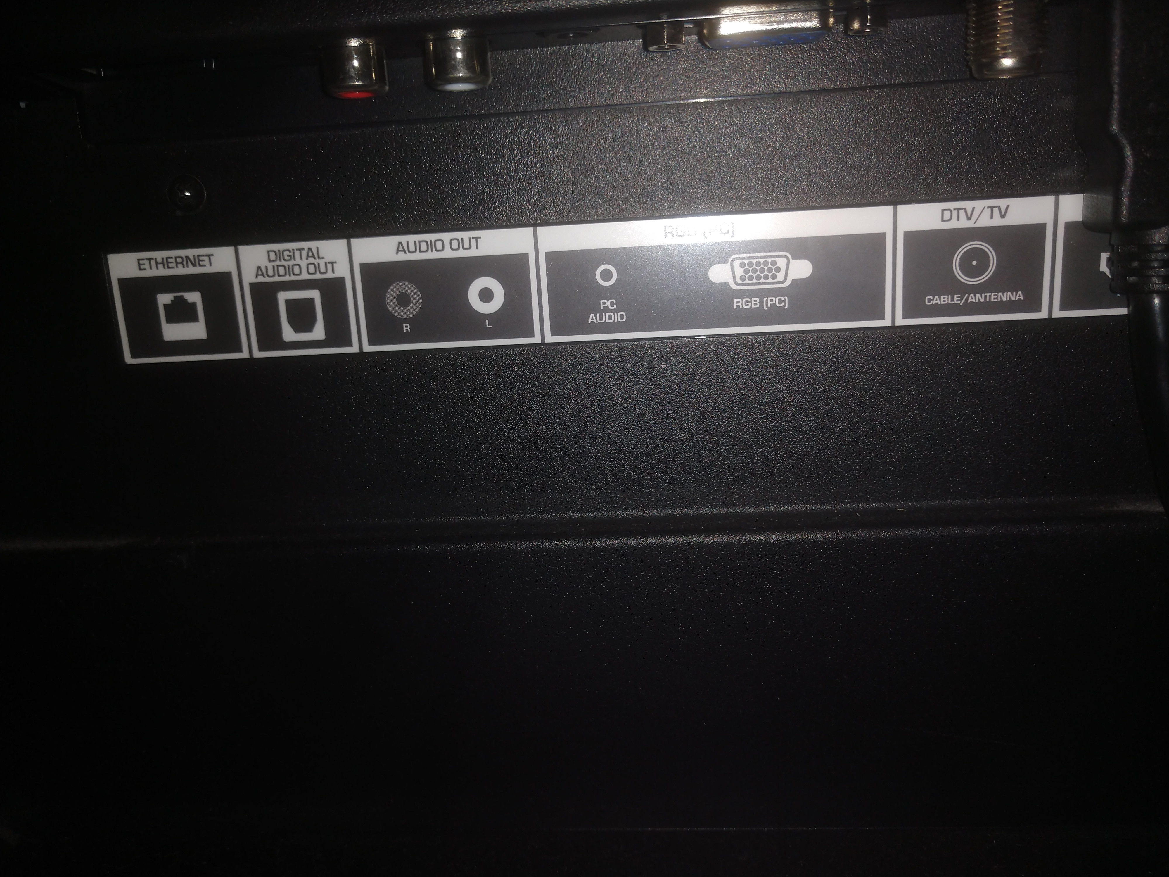

 [Attachment 47215 - Click to enlarge]
 Idk if this helps, a picture of the back of TV connections.
	I have a couple of these: https://www.amazon.com/gp/product/B00IK9UZXA/ref=oh_aui_search_detailpage?ie=UTF8&psc=1
 As Cornucopia stated, the transmission sound quality is okay, but not great. There are some new standards that are supposed improve quality, but you need to make sure both your transmitter and speakers support them. Your speakers may sound great for music, but the sound will likely be dwarfed when used for watching movies. Part of the effect of a 65" HDTV is that your speakers are ~4 feet apart, giving you a greater stereo and surround effect.
	Your speakers have a standard mini-phone plug. Get one of these (in whatever length you need) https://www.amazon.com/Cable-iXCC-Shielded-Gold-Plated-Stereo/dp/B019D048XC/ref=sr_1_2...eo+cable&psc=1 and connect it directly to your speakers. You'll probably need one to connect a bluetooth transmitter to your TV's audio out anyway.
