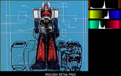

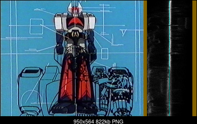

    Love Danguard! Animation capture is not the best to judge for quality.
    I did not notice the black crush:
    There are "black frames" on both catures.

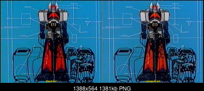

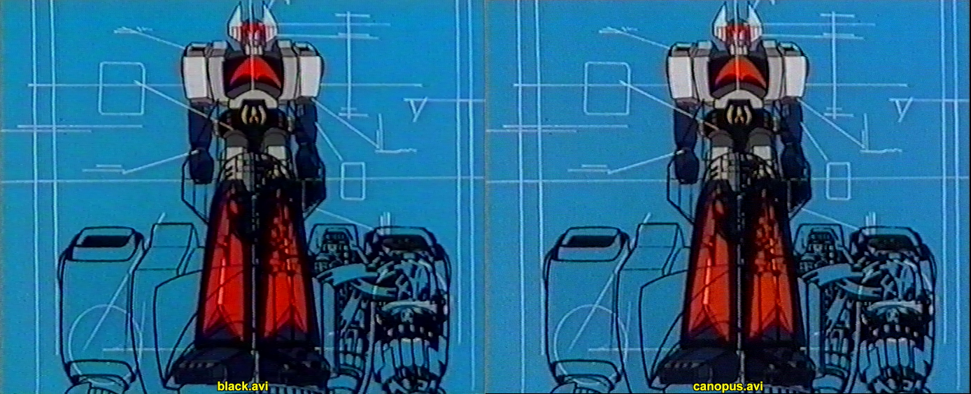

    The 2 captures are very similar, once tweaked for similar look:
    with image slider: https://imgsli.com/MzQ4NDk0

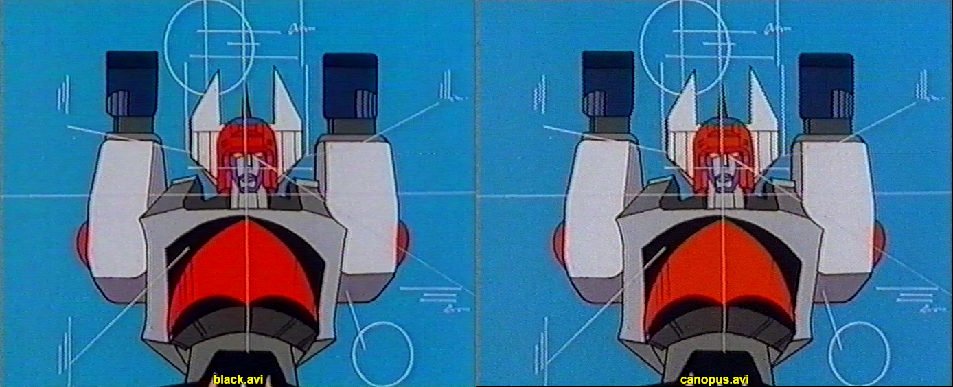

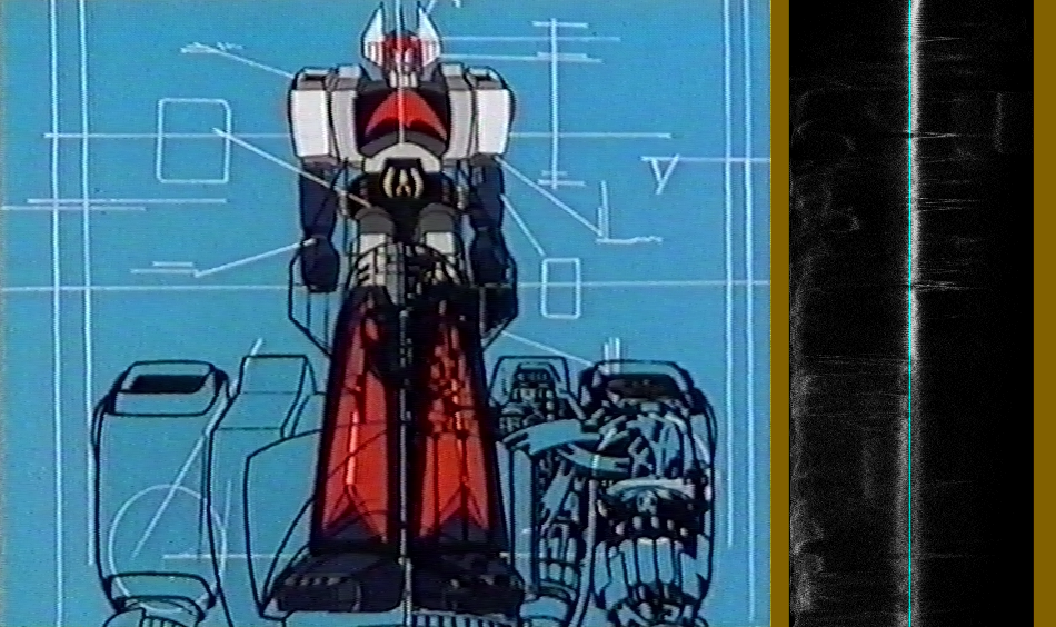

    The canopus capture has a distortion to the left on the top of the frame at the end of the video.
    The canopus capture has some more "artifacts" on the red color parts, and in general more noise in the borders between areas of different colors:
    with image slider: https://imgsli.com/MzQ4NDk1
