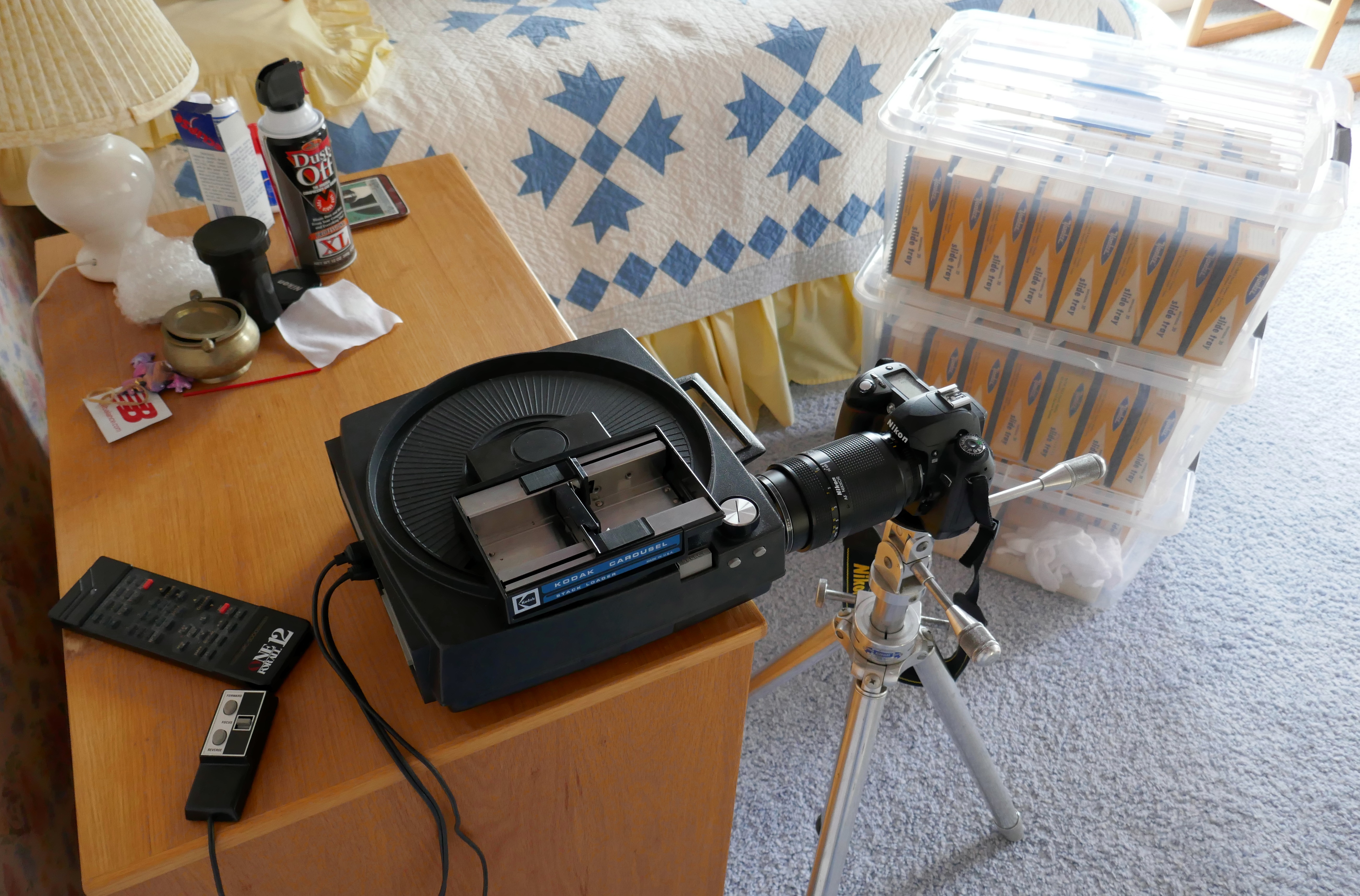

    BTW, one of the many other problems you will encounter doing what you are doing is that you will get a hot spot in the center of the frame. You can eliminate this, as well as dramatically increase resolution if you get a telephoto lens for your projector, and then point your camera directly at the projector. You'll need to figure out how to dim the bulb (or simply install a low-wattage bulb). You can also use a neutral density filter on your camera. If you get the correct lens and have enough telephoto on your camera, you can capture the image without having to project it. This gets rid of all the scatter you get from a screen; it eliminates the hot spot; and you get a really sharp image. The image below shows a slightly modified Carousel projector that I use to quickly "scan" slides. I have a very nice Nikon slide scanner, but it takes 90 seconds per slide. By contrast, I can capture about 12 slides a minute with this rig.
Name:	Slide Transfer System.jpg

  6. I was NOT suggesting that you use a slide projector to transfer movie film. I only included that picture of my 35mm slide projector setup to show you how you can capture the image directly, without projecting onto a screen.
    I frame-by-frame transfer of movie film (a.k.a. "frame accurate") is done with a modified projector that has some sort of trigger added to tell your camera when to take a picture. You then use either a video camera or still camera.
