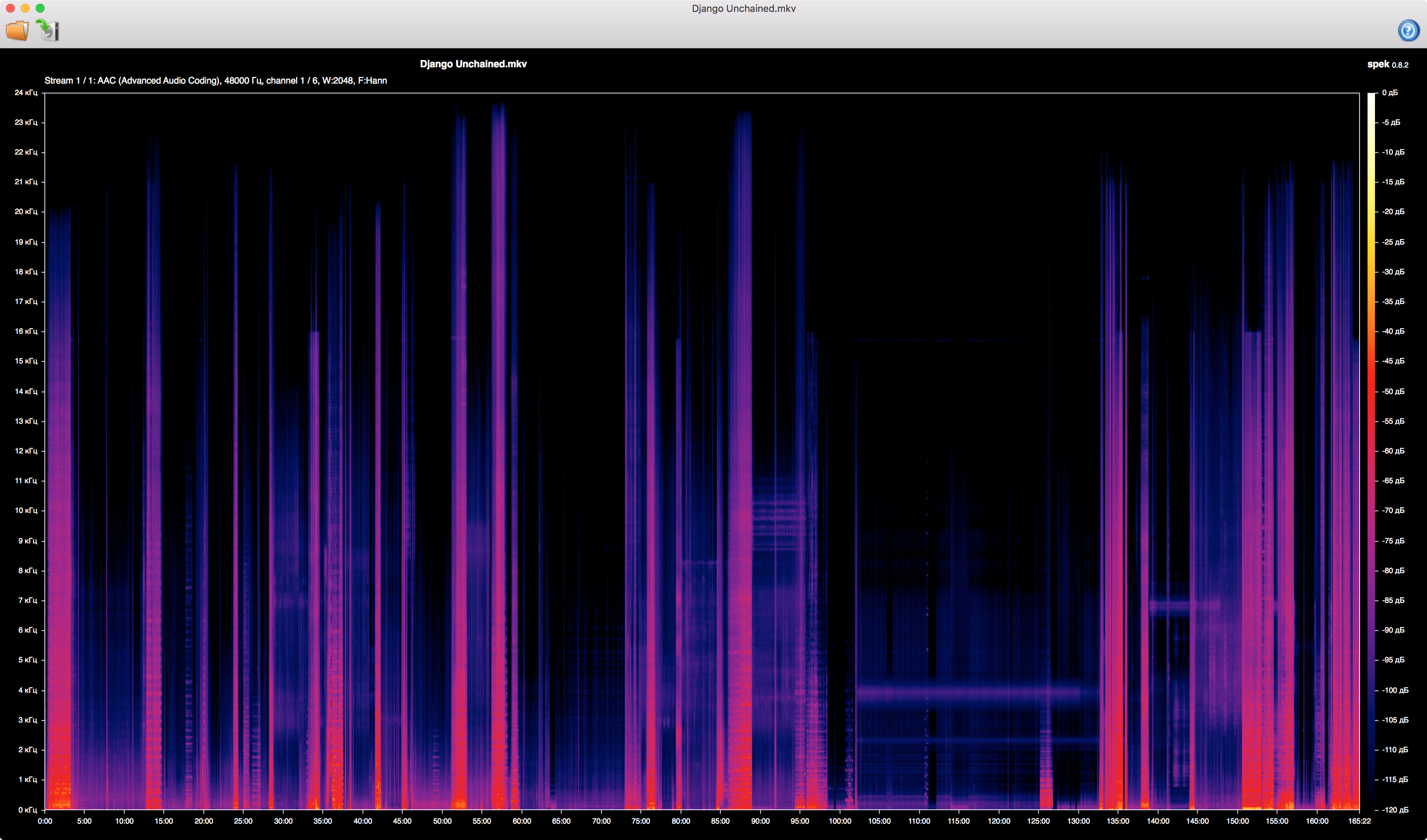

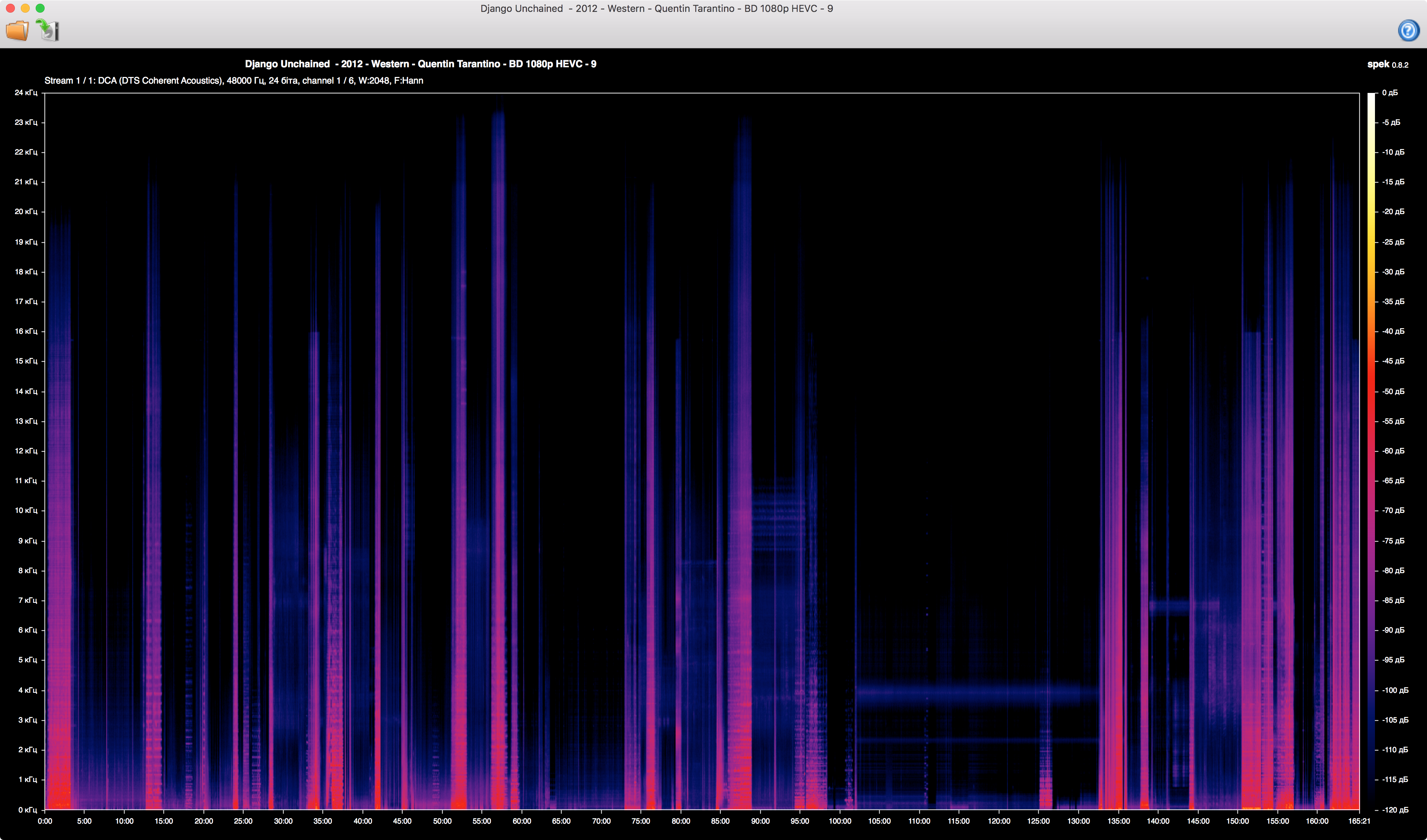

    Overall, AAC spectrogram @ 900 Kbps converted from lossless DTS-HD MA, looks much sweeter to me than DTS Core @ 1509 Kbps.
    I just wasn't quite sure if converting to AAC will not add some additional artifacts and sounds worse than plain DTS Core.
    So I'll stick with AAC.
Name:	AAC 5.1 900 Kbps.png

Name:	DTS Core 5.1 1509 Kbps.png
