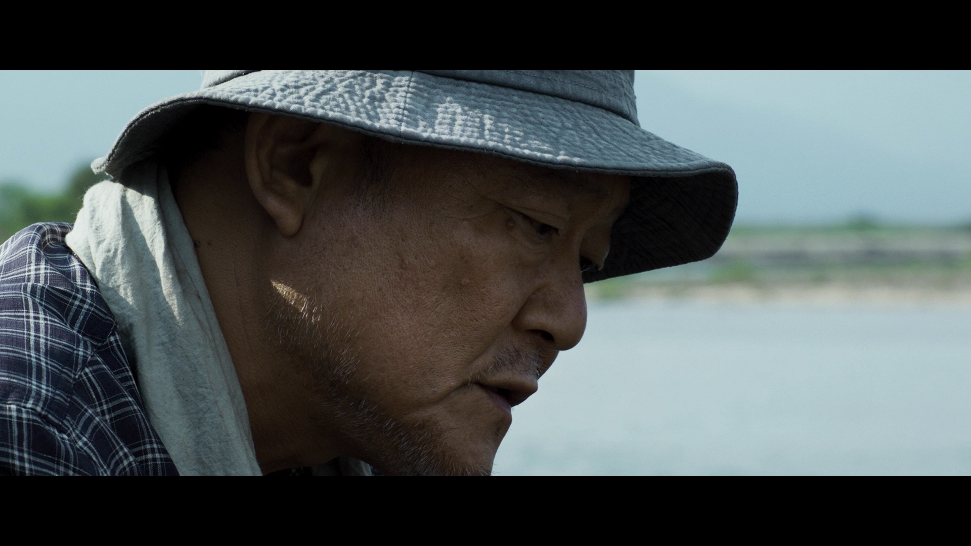

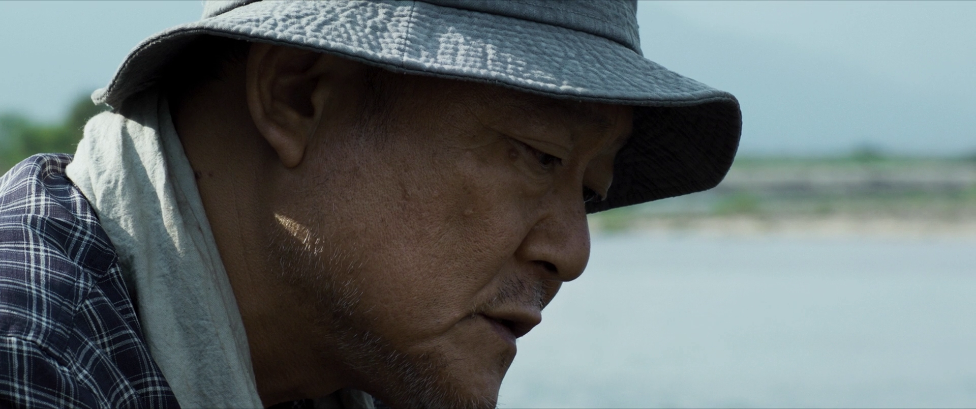

    I am a newbie to video encoding.
    I've tried to encode 2 min sample from Bluray source with CRF 18 and slow preset using both codecs: HEVC (H.265 10 bit) and AVC (H.264).
    The encoding was done with HandBrake Version 1.1.2 (2018-09)
    Using the same CRF 18, AVC looks better to me than 10-bit HEVC compared to the source.
    HEVC encode looks a bit blurred compared to AVC. So I am trying to figure out why is it so.
    As far as I know, CRF values differ for HEVC and AVC. HEVC CRF 18 ~ AVC CRF 16.
    So I don't understand why 10-bit HEVC looks not so sharp as AVC. Or maybe I need to tweak some other encoding parameters?
    Thanks!
    ________________
    Attaching Bluray source, x265, x264 screenshots and MediaInfo for both encoded files below
    x264

  2. It's not the same frame ;
    Also no frame type - eg. maybe you're comparing a higher quality IDR frame to a low quality b-frame etc..
    x264 uses 12% more bitrate according to your mediainfo report (not comparable; usually +/-1% deviation is acceptable, but 12% is significant)
    sao tends to oversmooth for x265 . Many people disable it if it's not simple cartoon, or simple source, or intended lower bitrate target . Also people tend to use lower deblock (negative) and higher psy-rd , psy-rdoq settings for BD film sources
    Also something wrong with either your screenshot method, up/down bitdepth conversion method, or encoding - there is a green hue shift for the x265 screenshot
  3. Blurring seems to be a common x265 complaint. It might be better for 4k but for 1080p or lower I'd stick with x264.
    It's been said (I haven't tested it myself as I only use x264) the psycho-visual options help with the blurring, although for a given CFR value they'd probably increase the bitrate. https://forum.videohelp.com/threads/390036-Can-the-smoothness-or-blurred-look-of-x265-...ed#post2527784
  4. Thanks, poisondeathray and hello_hello.
    no-sao fixed the issue
    I captured the screenshots in VLC with 'Jump To second' method, so frames could be shuffled. What's the proper way or tool to get a specific frame?
    I saw lots of encodes with deblock=-3:-3, so will keep that in mind as well. Not sure trough how high should be psy-rd and psy-rdoq settings.
