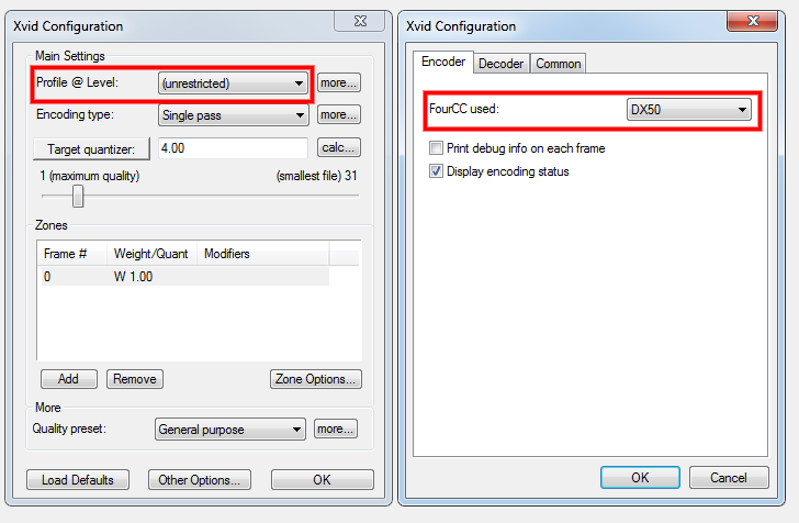

You can use XVid and just configure XVid to use DIVX fourcc code instead default one.
Yes it is. Choose any of the non-Xvid presets, click on the Other Options button at the bottom center of the dialog, then select the fourcc:
[Attachment 47151 - Click to enlarge]
