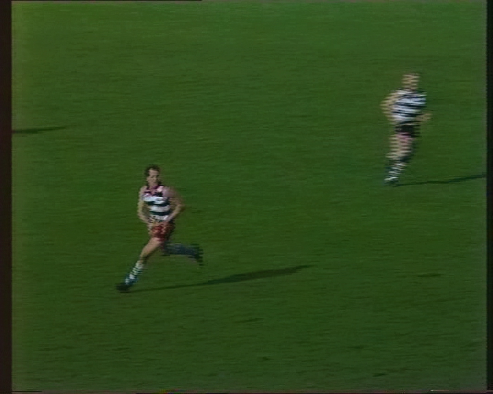

I am wondering if anyone on here could help me in regards to some chrome noise.
I have been capturing old VHS tapes from the 1980's using a VideoMate DVB-T300 analogue capture card.
I am capturing via Virtualdub and using Huffyuv as the compression format.
Now my issue is very minor but because it is sport, it is much more noticeable when playing a clip opposed to still frame of the issue.
[Attachment 47111 - Click to enlarge]
As you can see, there is pink noise appearing in small sections of the captured video.
I am trying to use avisynth to correct this but nothing so far has worked.
Can anyone help me?

I recommend you post a huffyuv video sample. But basically, VHS has very low color resolution -- about 40 lines across the entire screen. So colors get smeared quite a lot. It's possible to sharpen and shift them for better alignment. I usually separate fields, downscale horizontally, sharpen horizontally, upscale back to full width, and weave. Merge that chroma with the original luma.
Code:AviSource("filename.avi") luma = last SeparateFields() BilinearResize(288,height) aWarpSharp(depth=10) Sharpen(0.5, 0.0) nnedi3_rpow2(2, cshift="Spline36Resize", fwidth=720, fheight=height) # or needi3_rpow2() ChromaShift(c=-2) # whatever works Weave() MergeChroma(luma, last)Last edited by jagabo; 6th Nov 2018 at 22:08.
thanks so much for helping me out jagabo. Much appreciated.
Here's a small video sample (51MB) https://drive.google.com/open?id=1jBuK0sSePVqpgxI6FluPind5iMn3EpA3 -

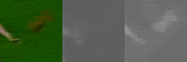

VHS has very low chroma resolution so colors are always smeared horizontally. You had an additional problem where the color of the two fields was blended together:
[Attachment 47133 - Click to enlarge]
On the left is a crop of two consecutive fields from the original video. To the right of that are the two corresponding chroma channels. You can see the motion of the ball in the left image. But there there is very little motion in the chroma channels because they have been blended together. You can see evidence of this in the left image -- the brown color of the ball appears in the grass, ahead of the ball in one frame, behind the ball in the other. Ie, the chroma isn't moving with the luma.
There are also horizontal stripes in the chroma. I believe these are Hanovor bars -- after incorrect conversion to RGB.
https://en.wikipedia.org/wiki/Hanover_bars -
The problem is in the capture device/driver/software, not the VHS deck or tape.
