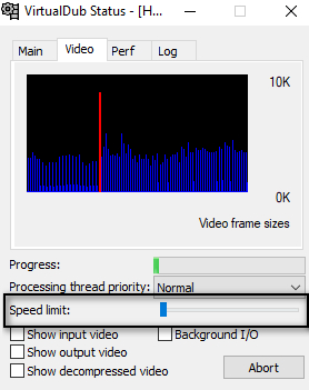

    is it possible to pause virtualdub when it says dub in progress
  2. In dub status window there is speed limit option. When I set it to 0 (leftmost) it does pause for me. AFAIK this is the only way.

    Well I have version 1.10.4 which i believe is the latest but cant see pause in status window
    EDIT: oh sorry you mean this slider move to far left to pause great it works
