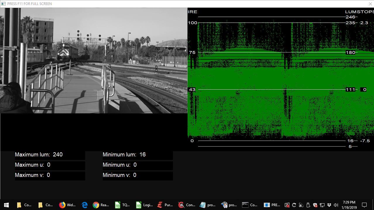

But I think I figured out what's wrong with your program. So you were expecting to see something like this?
[Attachment 47864 - Click to enlarge]
The problem is that you aren't getting YUY2 data from the decoder, you are getting a U plane, a V plane, and a Y plane. Ie, instead of:
You're getting:Code:YUYV... (a total of 1280x720x2 bytes)
It should now be obvious how to fix your code now.Code:UUUU... (a total of 640x720 bytes) VVVV... (a total of 640x720 bytes) YYYYYYYY... (a total of 1280x720 bytes)
Now it works. I changed the pixel format to yuyv422:
I had tried that before with no success, but it works now.Code:pipeIn$ = "-i " + filename$ + " -f image2pipe -s 1280x720 -pix_fmt yuyv422 -r 59.94 -vf zscale=in_range=limited:out_range=limited -vcodec rawvideo -"
