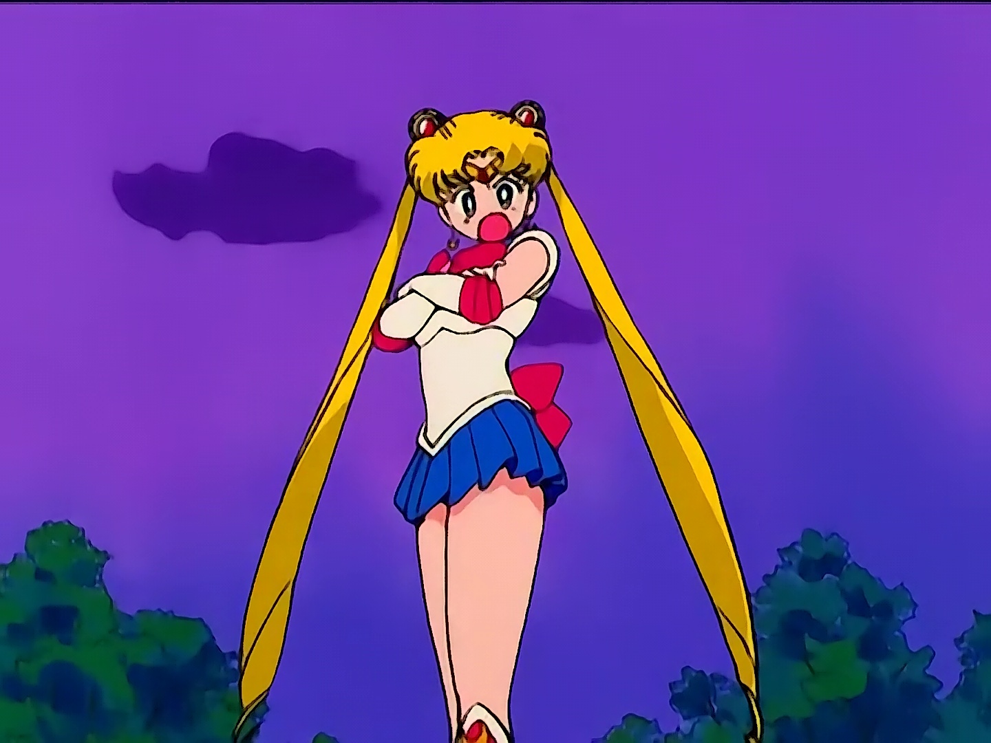

  1. Hello again. I've been here previously with almost the same topic, but this time I think I can explain it better.

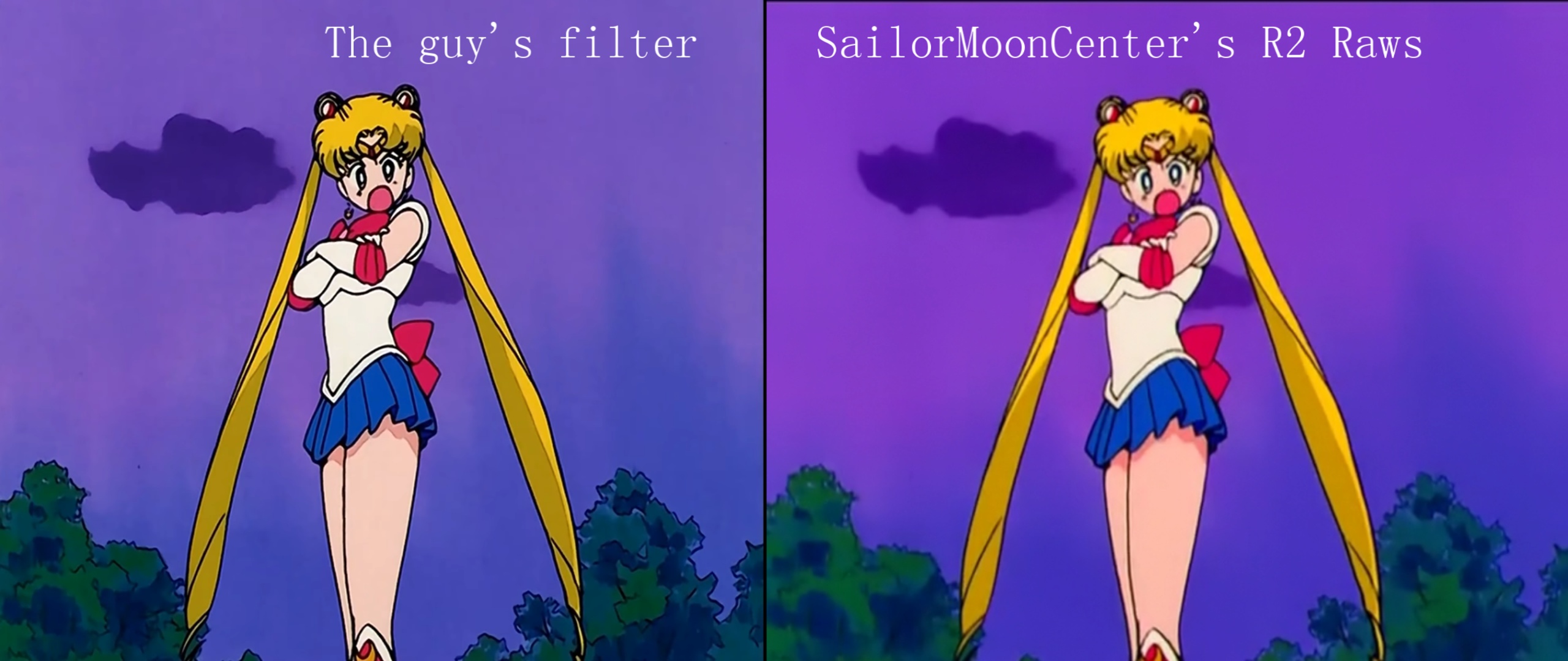

    So, just with a comparison may explain it all.
    [Attachment 47086 - Click to enlarge]
    Video of his filter (blocked in the USA): https://youtu.be/sw8uC1xxcEw?t=51
    Using Avisynth, my result is:
    [Attachment 47087 - Click to enlarge]
    What am I having trouble with is that the lines aren't as dark and as sharp as his, and mine look a bit transparent. I would like to know if anyone could help me with making something the same as his.
    My code is:

    Cut of their raw included in attachments (original file is MKV, but I cutted it on VirtualDub2 and saved as H.264, the usual I do)

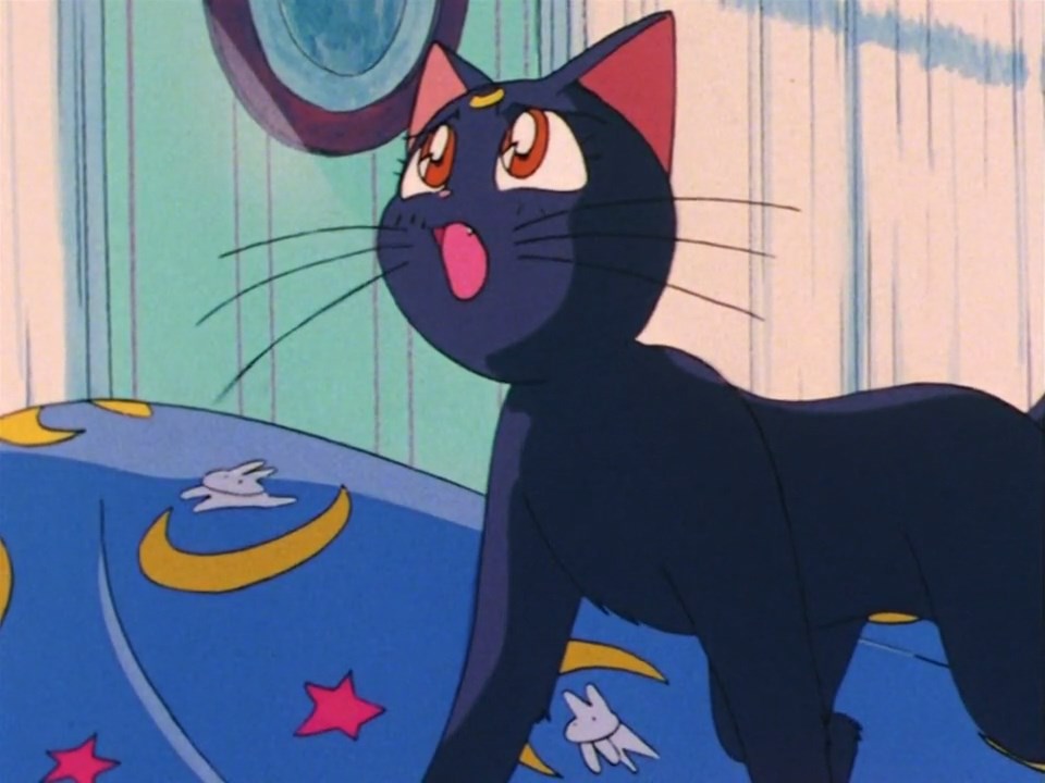

  5. Hey also, how about remove the noise of it? I have recently got higher quality RAWs but they're a bit noisy.Image
    [Attachment 47154 - Click to enlarge]
