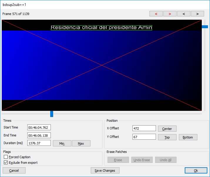

Had some time to fiddle around with it.
It's a ~10 MB *.SUP File from a BlueRay Disc.
There are a total of 563 Subtitle Lines
About Half is Positioned at the Top Screen, the other half is on Buttom Screen.
I want to *completly* remove all the Subs which are display on the Buttom Screen and make a new *.SUP File from it.
I would like to Keep all the subs positioned, on the TOP SCREEN
And completely remove all the subs, that are positioned on the BUTTOM Screen

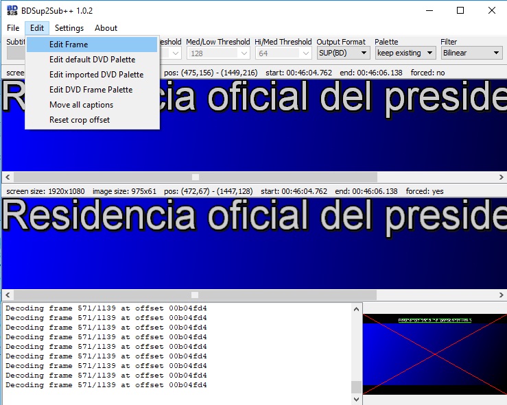

@Knackstiefel You can do it with BDSup2Sub
[Attachment 47097 - Click to enlarge]
check the option: exclude from export .. and the save changes. OK ... File->Save/Export-> BD Sup
