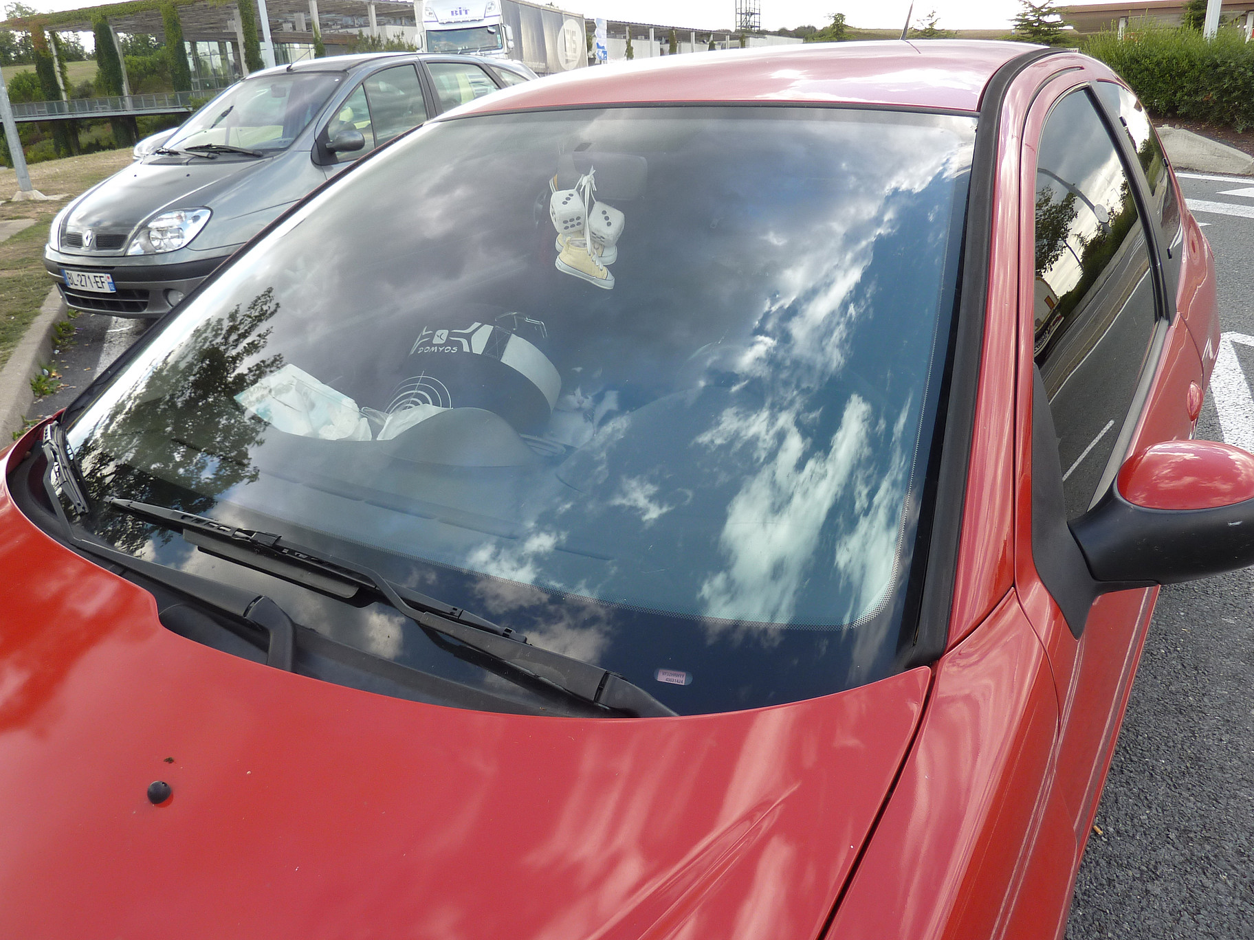

    I've done some tests with a video I created which at some point near the begining shows a still picture I took of a red car. Here's the native picture (just resized by 50% and saved with XnView to JPG q90 with the best sub-sampling setting) :
Name:	P1250282 [50% q90].jpg

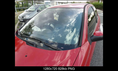

    Now, I opened the video in question (which I had encoded in 1280x720 using MeGUI with “ConvertToYV12(matrix="Rec709")” in the Avisynth script) with several video players / converters and made a screenshot : it turns out that they treat the color conversion differently, which would explain the issue described above.
    VLC Media Player :
Name:	20140821.mp4 - 00_00_04 -2018-10-30-03h53m37s212 [VLC Media Player].png

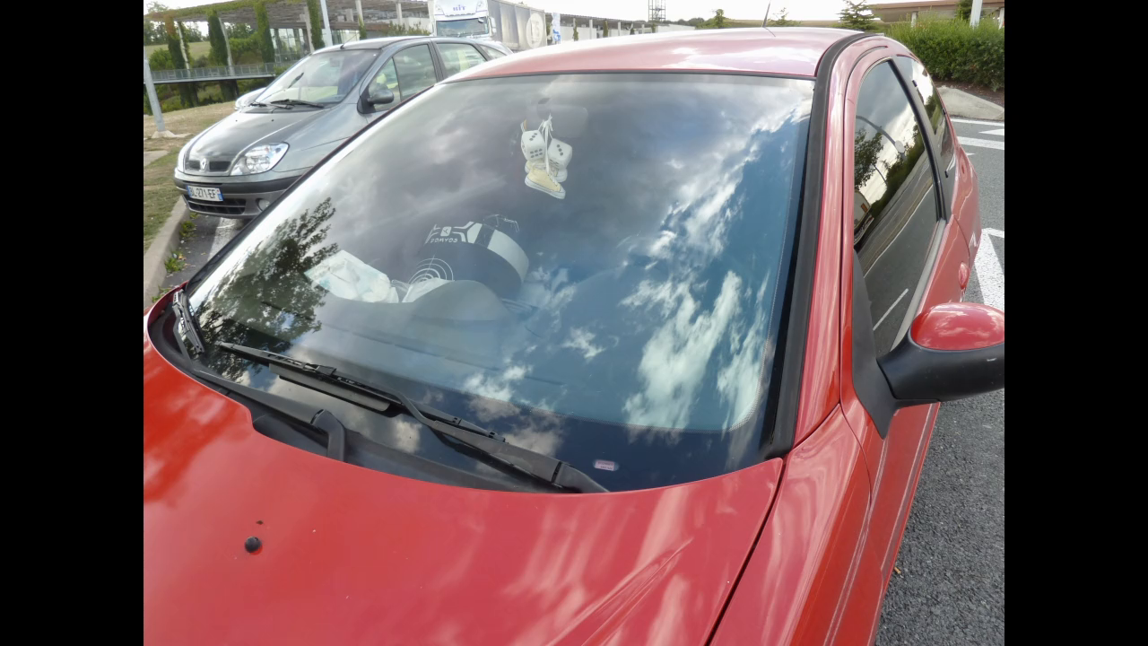

    SMPlayer :
Name:	20140821_00_00_04_001 [SMPlayer].png

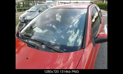

    MPC-HC :
Name:	20140821.mp4_snapshot_00.00.04_[2018.10.30_03.53.57] [MPC-HC].png

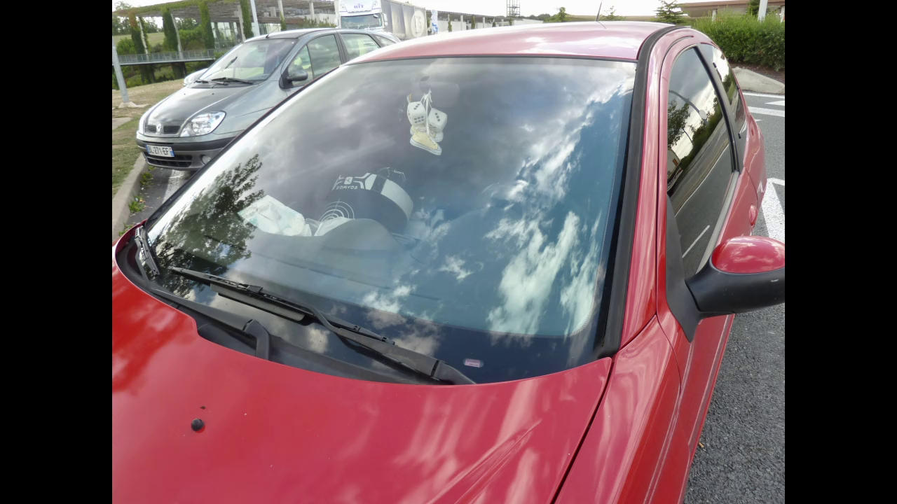

    ffmpeg (-i input.mp4 -vframes 1 -ss 00:00:05 output.png) :
Name:	20140821 0m05s [ffmpeg].png
    SMPlayer and MPC-HC reproduce the colors accurately, VLC and ffmpeg do not (the car's color is a darker shade of red, while the leaves in the background are a lighter shade of green).
    With the tools I tried to create thumbnails preview, I get different and seemingly more accurate colors with SMPlayer, compared with the others, some of which are based on ffmpeg (even the commercial one...).
    Why this behaviour ? According to what I've read here repeatedly, “HD” video is supposed to be converted with the Bt.709 matrix, apparently several prominent softwares do not respect this convention.
    Is there a ffmpeg switch which could make it generate screenshots with accurate colors ?

  8. If the source is flagged with metadata correctly, it looks like ffmpeg will do the conversion correctly , sometimes if you write to bmp as-is (ie it reads the flags). But if you use colormatrix in that case, it will reverse it, sometimes making it wrong. So that's another reason to avoid -vf colormatrix unless you know for sure it's flagged or not and if it's correct or not. The quality is also lower, because it's actually converted twice (2 generations of rounding errors) .
    For -vf scale , it also matters if source is flagged or not. To get around that, you can specify both in and out colormatrix explicitly, and that should work in all cases (except full range, but you can specify in_range, out_range too)
    -vf scale=in_color_matrix=bt709:out_color_matrix=bt709
    Same with zscale, you can specify matrixin, and matrix explicitly , if you need to , so most types of videos are covered (flagged and unflagged) , and you can specify rangein and range if you need to (for full range)
    -vf zscale=matrixin=709:matrix=709,format=rgb24
    Note there are some HD videos that are known 601. For example many canon DSLR's shoot this way as a notable exception to the "HD is 709" rule

    Yes, I've read this when searching about that issue. But in this particular case I know how that particular frame is supposed to look like (the original source being a still picture that I have).
    With this switch it worked as expected, the colors are now correct, even in PNG :
Name:	20140821 ffmpeg zscale bt709.png
    And with “-vf scale=in_color_matrix=bt709:out_color_matrix=bt709 ” the output is exactly the same in PNG or BMP (same size, same checksum).
    VLC's color rendition can be seriously affected by the Video/Use hardware YUV->RGB conversions setting and the consequent settings in your graphics driver.

    Anyway, I managed to get the intended result (screenshots here) by modifying the ffmpeg calls in the script as follows :
                    ffmpeg_command = [
                        "ffmpeg",
                        "-i", self.path,
                        "-ss", time,
                        "-vframes", "1",
                        "-vf", "zscale=matrixin=709:matrix=709,format=rgb24",
                        "-s", "%sx%s" % (width, height),
    I wanted to install both versions side by side, tried to install the modified script as “vcsimod”, by replacing all mentions of “vcsi” by “vcsimod” in “setup.py” file and some other files in the package, but it didn't work, I got a “ModuleNotFoundError” when calling vcsimod (although the modified script was apparently correctly compiled as vcsi.exe in the “Python3\Scripts” directory), so I had to install it over the native one. Problem is, the colors might be inaccurate for “SD” content, which usually legitimately use Bt.601 color conversion matrix. So, does anyone know what I should modify where in the original package to install my modified script with a different name ?
