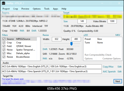

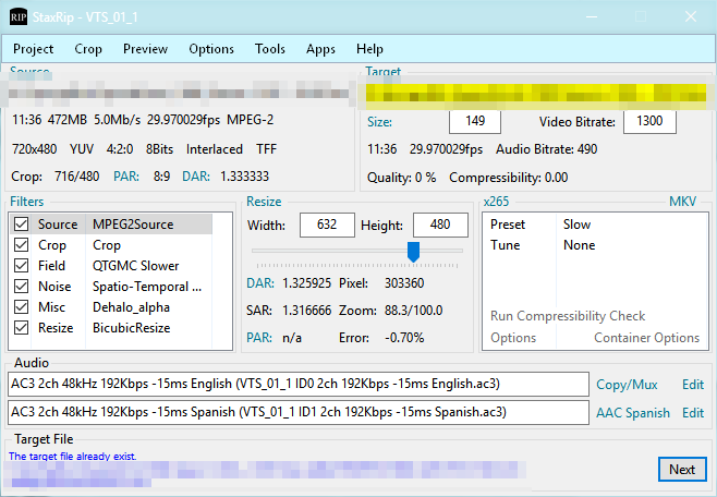

  1. Here's what I did:
    DVD Decrypter to get the .VOB
    StaxRip to encode.
    The VOB's length is 11:36, but my rip is 35:17. If you try to go past 11:36 it just cuts to 35:17 and the video ends. Why is this happening, and how do I fix it?

  2. VOBs aren't meant to stand alone. You need the IFO files to determine how they should be accessed. Use a program like VOB2MPG to extract titles from a VOB/IFO set. The resulting MPG files will be just the data you want.
  3. Originally Posted by jagabo View Post
    I do have the IFO files. I used DVD Decrypter in IFO mode.
    VOB2MPG doesn't work for me.
