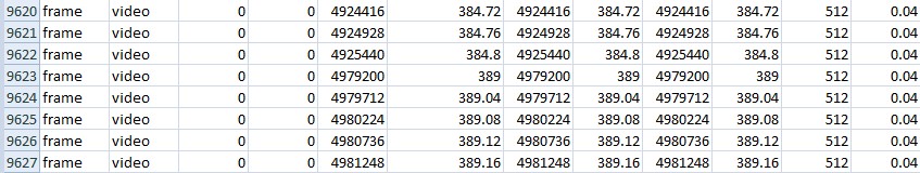

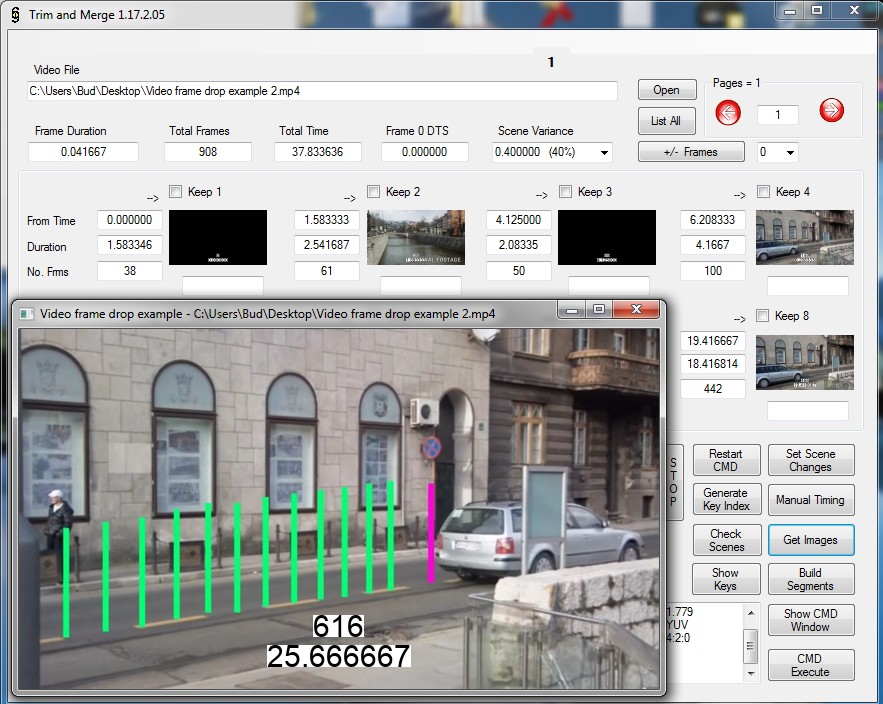

Usually dropped packets from streaming video usually causes a jump in DTS/PTS time that can be checked with ffprobe but FFprobe is not a speed demon so 'Quick Scan' would be not so quick unless you know approximately the area of skip.
[Attachment 47026 - Click to enlarge]
In the case of you sample there is no gap because I assume this is a manufactured video since 25.666667 / durartion (.041667) is approximately frame 616.
the following is from one of my videos with just what you mention.
[Attachment 47027 - Click to enlarge]Last edited by Budman1; 26th Oct 2018 at 23:31. Reason: added examle
