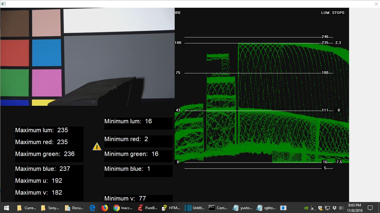

  7. It gets complicated. The ultimate objective is to make camcorder video EBU r 103 compliant.
    https://tech.ebu.ch/docs/r/r103.pdf
    The camcorder video is 4:2:0 YUV at 1080p. I then convert it to RGB24 720p because it is MUCH easier to control the individual R,G,B channels in the RGB domain. So we are making a round trip YUV -> RGB -> YUV. The camcorder puts out levels from 16 - 255. So far I've been working in Limited range but plan to experiment with full range to see how ffmpeg behaves. Distributors do not accept 1080p. In the U.S. we are still using MPEG2 for over-the-air video. The 6 Mhz RF channel handles 19.38 Mbps but this is usually divided up between a main HD channel and several SD subchannels as low as, say, 3 Mbps. There are really two standards: a "contribution" standard which is generally at 50 Mbs but is then scaled to a lower bit rate for broadcast, and that depends on how each station has divided its 19.38 Mbps. Each station resamples from the "contribution" standard for eventual over-the-air broadcast.
    In any event, there must NOT be Y, R, G or B information at 0 or 255 as these values are strictly for sync.
    The video is then converted back to YUV 4:2:2 because that is what distributors want. At this stage I alter the "lift" and "gain" using brightness and lutyuv. This is all checked on a special waveform monitor which reads out the minimum and maximum levels for each R, G and B channel. It's been difficult to achieve but has worked out nicely. If you have a better way of doing it I'd love to hear about it.
    I found it difficult to bring the R, G and B channels into spec in the YUV domain. You wind up sucking too much saturation out of the picture.

  9. Clamp between 1 and 254 (as SAV and EAV use 0 and 255)
    How is this done, Pandy? What is the ffmpeg command for it?
    I already have this code:
    lutrgb=r='clip(val,17,231)',lutrgb=g='clip(val,17,231)',lutrgb=b='clip(val,17,231)'
    I also set gamma in this process but omitted it from my post.
    not sure if any broadcaster use internally infrastructure to transmit RGB
    They don't. That's why I convert back to YUV.
    i assume 0 and 255 is not your problem as it is present only in display.
    Broadcasters will REJECT program material that is not up to their specs, i.e. they will not broadcast it. So it is my problem.

  12. If it's progressive "23.976p" content
    As I explained:
    For example, >90% of consumer grade cameras have usable data in the Y 235-255 range. Usable highlights that are recoverable. You don't want to just clip those - it will look ugly and get rejected in the subjective category because of abrupt changes instead of gradual fall off
    You can do this by simply reducing the video gain but then you're changing all of the picture level and this doesn't work in a dark scene unless you want to hand-grade every individual shot, which I don't.
    In SDR video anything over 90% reflectance is considered out of bounds (90% reflectance = 100 IRE = digital 235). You have to exert control either by using the camera iris or an ND filter or by choice of subject matter.
    This all changes with HDR and depends on whether you are using HLG or PQ. With HLG 100% reflectance is 75 IRE (out of 100). 90% reflectance is 73 IRE. I don't even want to think about PQ.
    There are other levels you need to worry about too , not just min/max values - "illegal" broadcast colors . Both YUV values that don't "map" to a "legal" RGB value, and things like illegal saturation values
    EBU r 103 only concerns itself with Y, R, G and B but yes, I keep an eye on those, too. r 103 also suggests low-pass filtering.

  21. Thanks for the advice on Premiere Elements. I use a program called Shotcut. It is very much a work in progress and a very ambitious endeavor. It cost $0 U.S. I have Premiere Pro in the back of my mind but I don't do $20 worth of editing every month.
    Here is the camcorder I use now:
    https://www.bhphotovideo.com/c/product/1211905-REG/sony_fdrax53_b_fdr_ax53_4k_ultra_hd.html
    Here is a handy spreadsheet I made. It works well for SDR but I don't have HLG down yet. As you can see, an 18% reflectance gray card should be at 43 IRE in SDR or "0 stops".
    https://docs.google.com/spreadsheets/d/1wGZd5_OEPSE08CC_RpP5X_hTxOgapWw7pihrKeFOWls/edit#gid=0
    It was Art Adams who turned me on to the use of an 18% gray card. I used to use something like this:
    https://www.markertek.com/product/ac-gse-9/accu-chart-9-step-eia-type-grey-scale-chart
    Here is the scope currently (needs some fine tuning).
    [Attachment 47125 - Click to enlarge]
