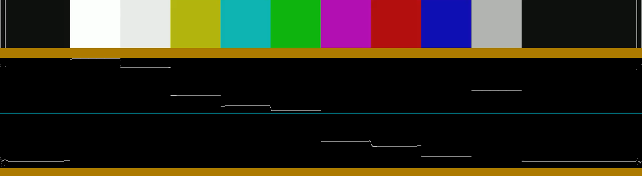

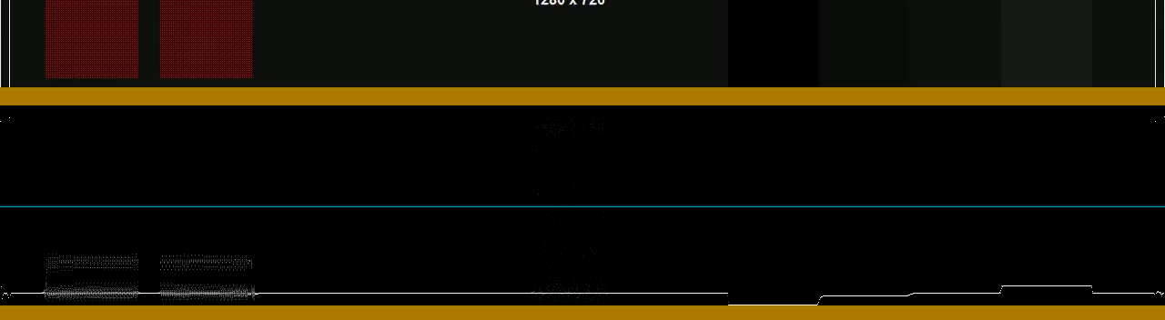

  5. Originally Posted by chris319 View Post
    That test pattern is limited range rec.709, not full range.
    Please explain. The test pattern as modified today contains video from #000000 through #FFFFFF.
    But those became Y values from 16 to 234 -- because a limited range matrix was used. Upon converting back to RGB with a limited range matrix the Y=16-235 range is stretched back to RGB=0-255.
    You can see that your RGB 255,255,255 patch has mapped to Y=234:
    [Attachment 47091 - Click to enlarge]
    And your RGB 0,0,0 patch has mapped to Y=16:
    [Attachment 47092 - Click to enlarge]
    Read up on video waveform monitors (sometimes inappropriately called histograms) if you don't understand what those images are showing. Those were made with AviSynth. The bottom of the graph (which is 256 lines high) is Y=0, the top Y=255. Between Y=0 and Y=15 are marked in brown. So is Y=236 to Y=255.
