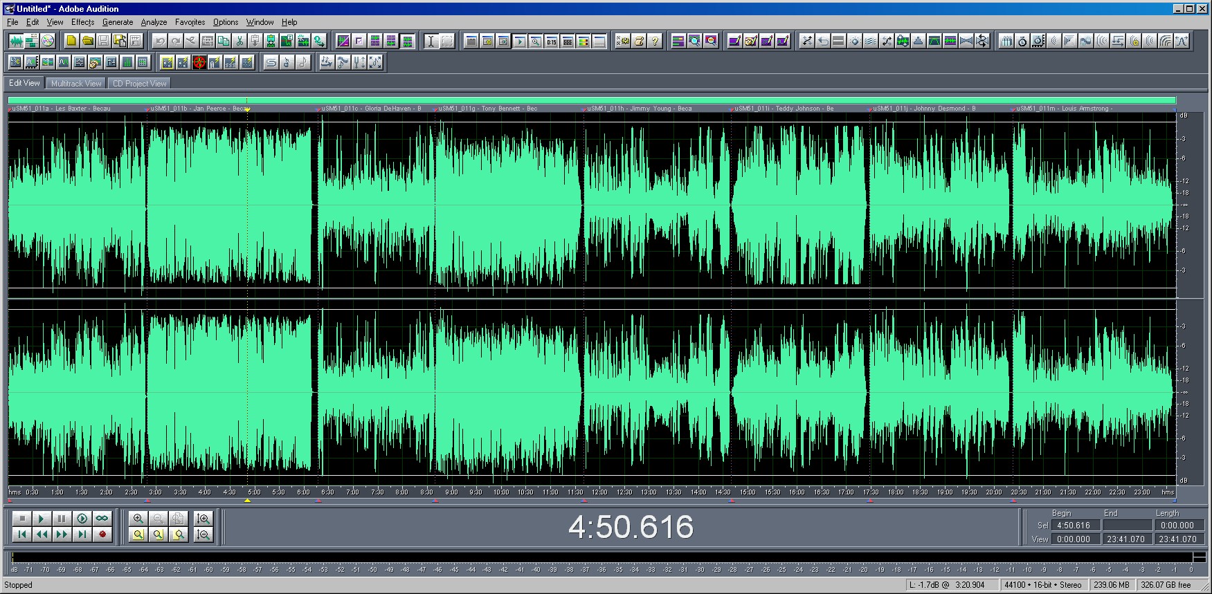

    Hi I've set Tools-RG Scanner-After File Content and ContextMnu-RG-Apply custom Gain as per your screenshots.
    Then loaded some files and "Apply track replay Gain to file content"
    This is all that's need for lossless volume adjust (i.e I'm not missing anything?)
    Results are quite good, and I think ok to achieve a better volume "match" with a batch of files. I'll attach A/B screen shots.
    I also tried a batch I'd adjusted manually and there was almost no change, which was as hoped.
    I didn't apply "True Peak Sampling" as tehre's seems no need, results were fine as is.
    And there is no change to tags, which is also good.
    Many thanks for all the detail.

    Screenshots A/B
    Track 2 and 6 appear louder than I'd set by hand, but that isn't too obvious just listening. And certainly better than original.
